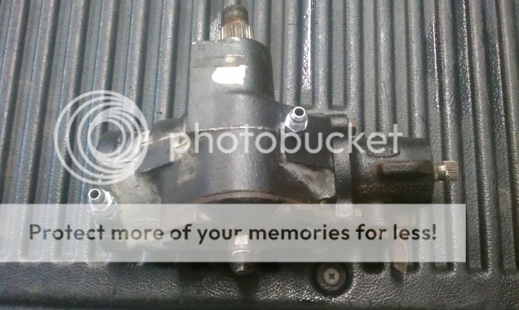

Got the tap done on the steering box.

And.... forgot about the steering box pitman shaft being bent and leaking like crazy. It's been out of fluid for a couple weeks....driving with manual steering really sucks
