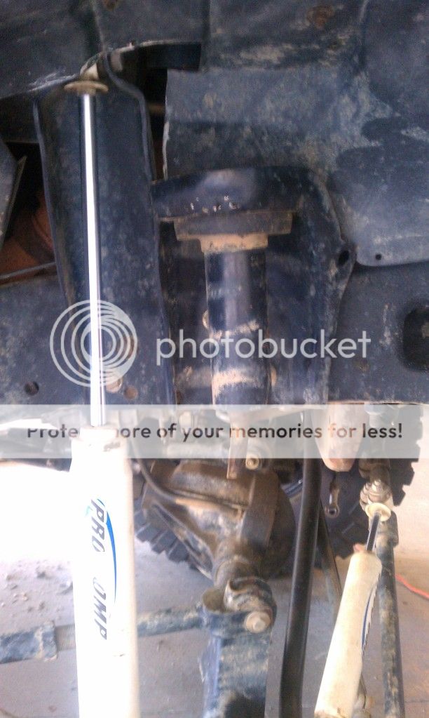

The bump stops are done.
Before...

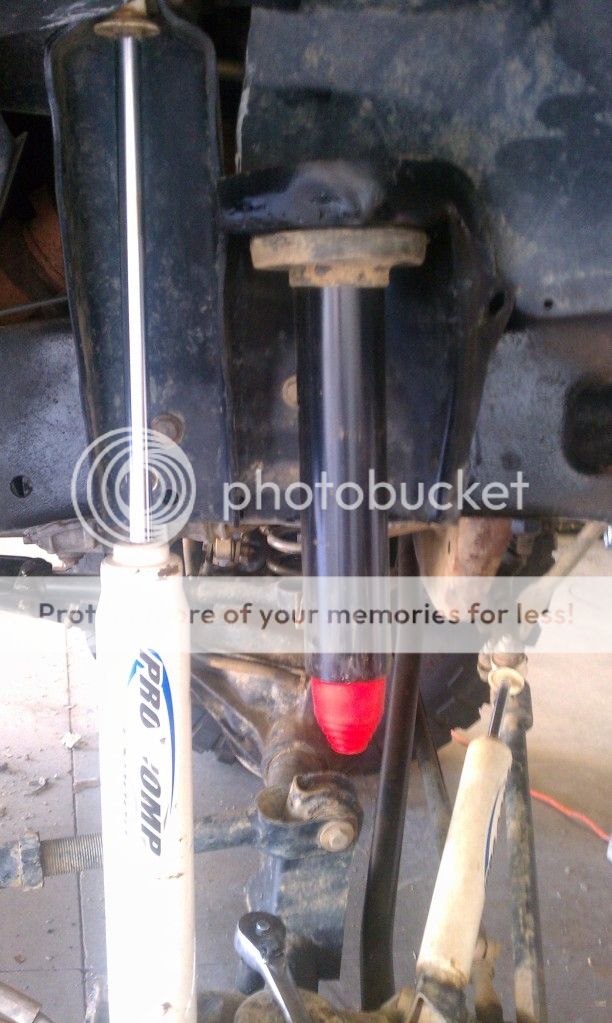

After...

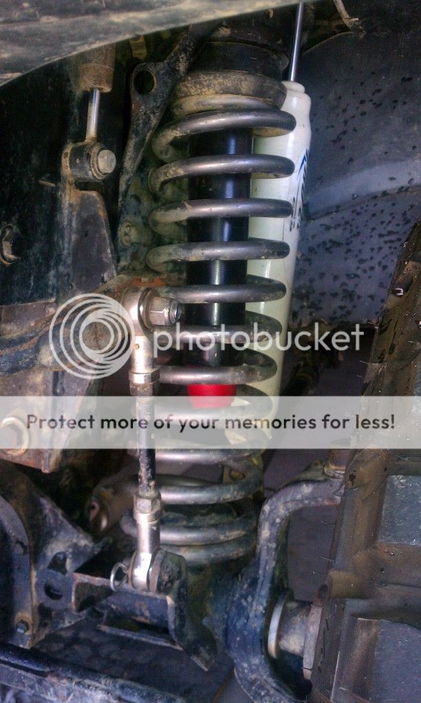

Finished...
Escorts 2nd SAS
Looks like it should work good, but the spring might rub on the passenger side when the axle drops.
