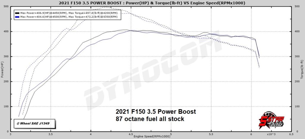

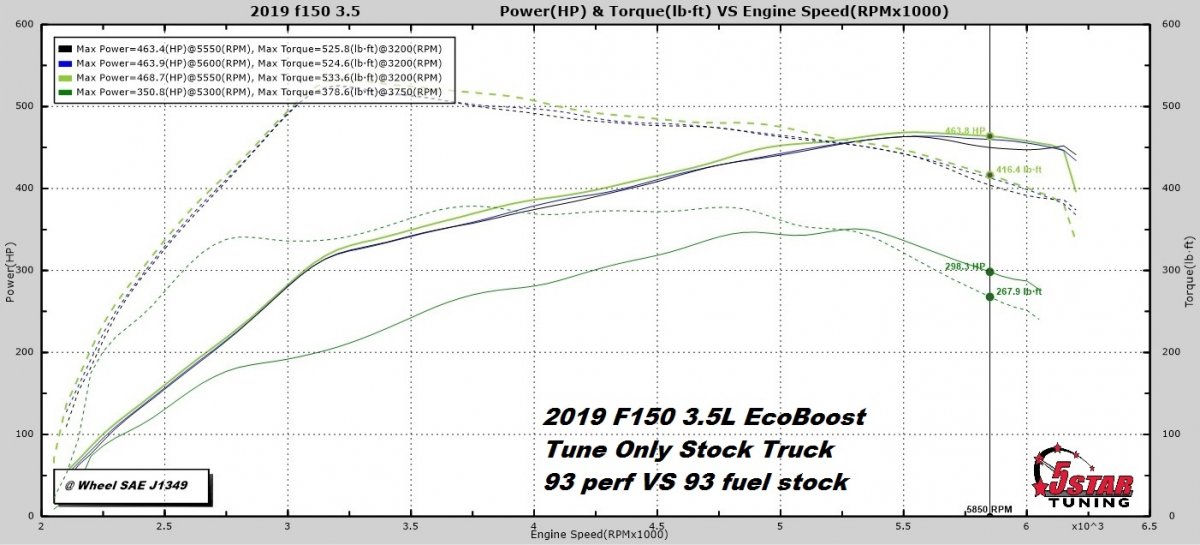

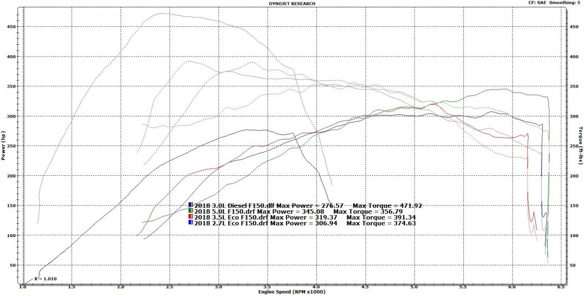

Just curious..do you have a power curve chart of it you can post? At the flywheel? I cant find any for the newer ones
That's close to 600 ft lb crank...570 rated....589 actual. The tire here is nuts
Ridiculous.

So .. wheel Dyno is tough to correct for.
But, pulled down on a engine Dyno the gen 1 is 420 ish ft lb at 2500 rpm.
Gen 2 moves down to 400...but 480 by 3k
Powerboost with pak is 400 plus at 2500. And 570 ish at 3200.
