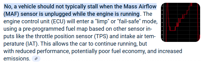

quick check, start the engine, and with it running disconnect the MAF, if the engine stalls entirely then the MAF passes to some degree - if the engine continues running the MAF is bad.

I am back at work, but we did unplug the MAF with the truck running. The idle dropped a little, but it idled smooth as could be. I almost ordered a MAF, but dug into it a little more and there are statements by others that say the engine should run with the MAF unplugged, as the ECU goes into a closed loop to protect the engine.
