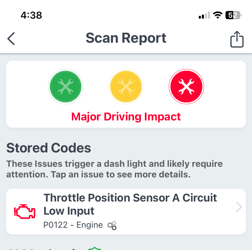

New issue, might be related. The Check Engine Light came on. I scanned it and it is a P0122 TPS Code.

how does the wiring around the TPS sensor look... since the ohms was good on the IAC valve, I am not surprised that replacing it had no change.... I like engine-codes better than any other site for OBD2 codes sine their troubleshooting seems spot on.
P0122:
Common Causes of P0122
A faulty Throttle Position Sensor (TPS)
Damaged wiring or connectors in the TPS circuit
Corrosion or poor connections in the TPS wiring harness
Issues with the ECM or other related components
3 out of 4 are TPS, so that would be my #1
I actually thought my IAC ohms were way out of whack, so I took a chance.
The TPS wiring looks good, nothing of note.
The P0122 code came into play after I messes with the throttle body blades. Once it was cleared it never came back.
