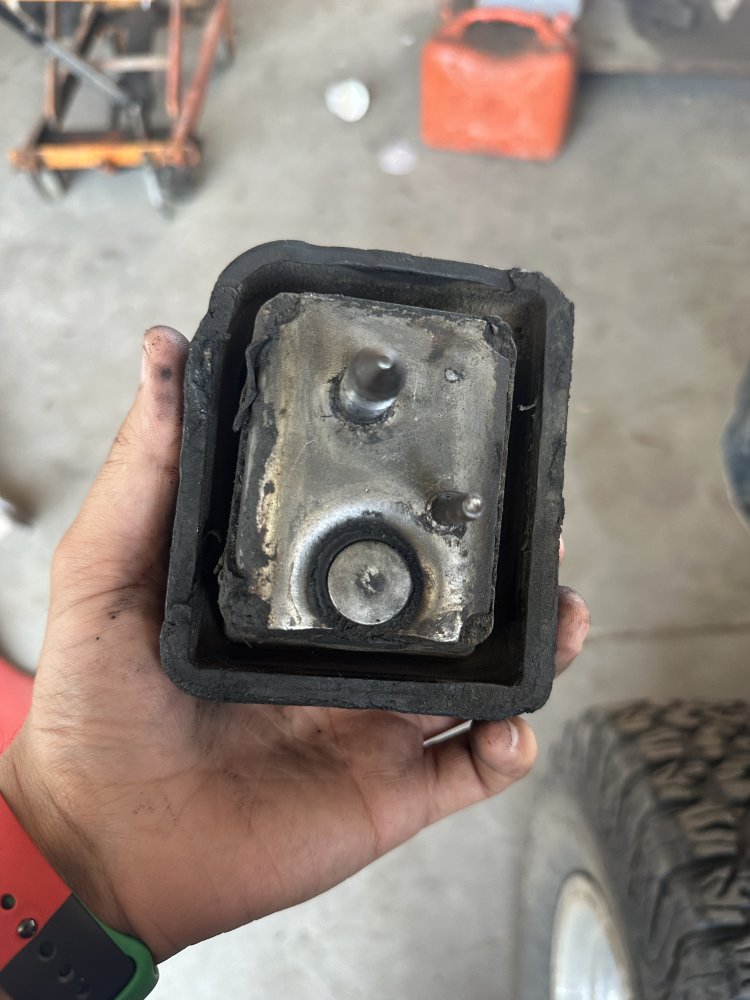

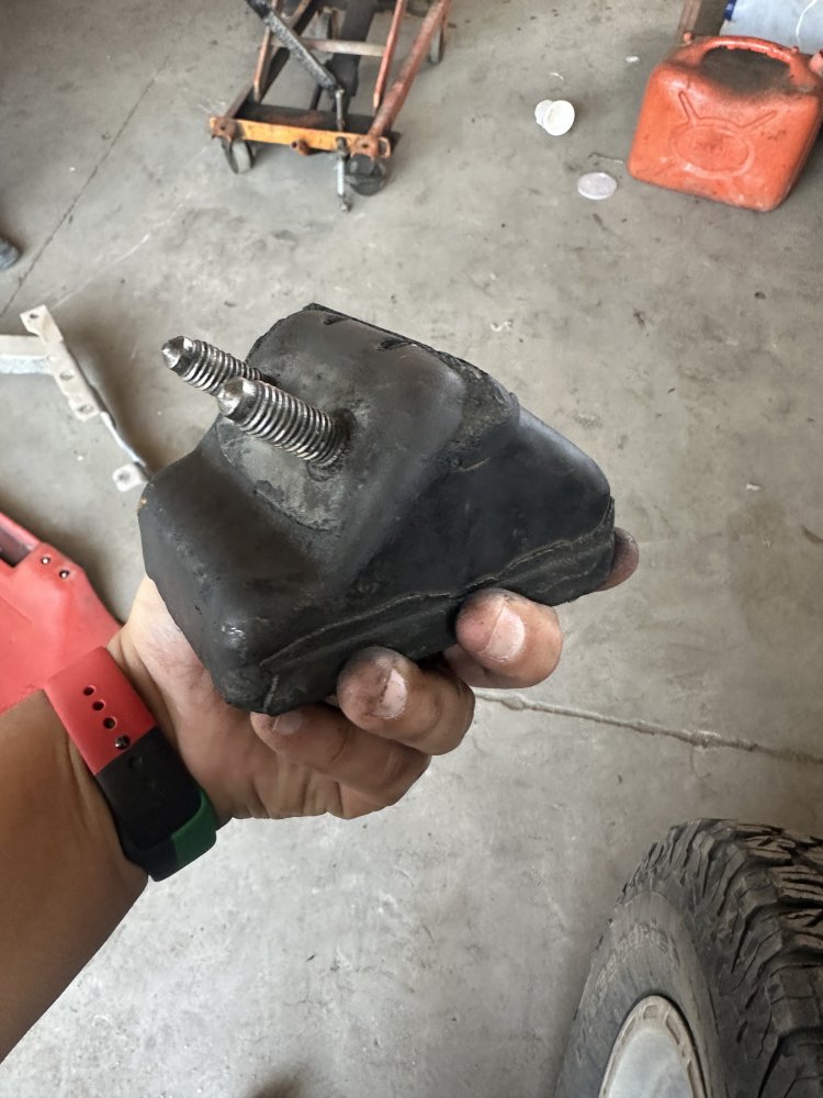

I have a problem with my Mazda B2500 00 Drive Side Engine Mount, I couldn't find it.
Engine Motor Mount Mazda B2500 - Soporte de Motor
It has a weird shape
But the passenger side is like the standard ones.
Could any one help me?

Tengo un problema con el soporte de motor de mi Mazda b2500 del lado del conductor
tiene sta forma extraña. Y no lo encuentro por ningún lado. Anexo fotos.
El del lado del copiloto si es como los que marcan en linea, ese fue fácil de encontrar.
Alguien me podría ayudar?

HI, IF THIS HELP ANYONE, I REPLACE THE DRIVER SIDE ENGINE MOUNT WITH A PASSENGER SIDE FROM ANOTHER RANGER SO I CAN FIT THE SAME MOUNT BOTH SIDES.
Hi how did you put the passenger side into the driver side? I’m currently having the same problem
You need to got to a junk yard and look for a driver side bracket from another truck and place it on the dirver side, is the same way to bolt in. Hope these help you.
If these help anyone, the mount that I need of the Driver side is the same for a 97 V6 Ford Ranger, hope these information help somebody (Just the driver side)
