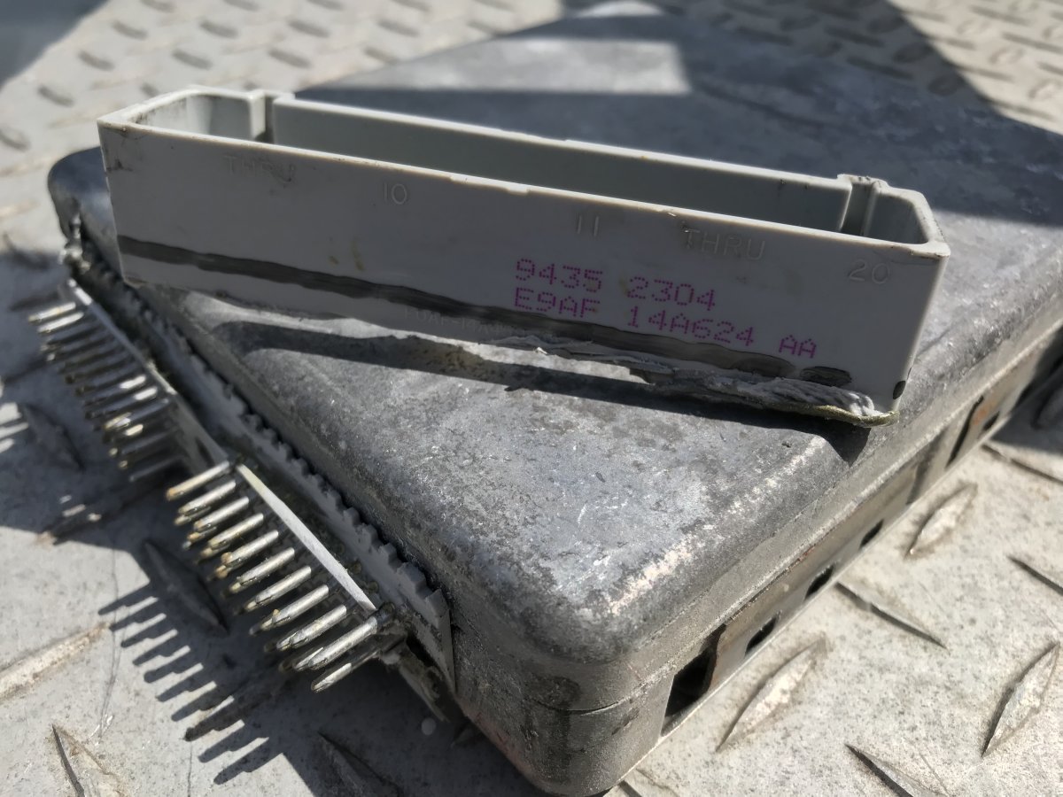

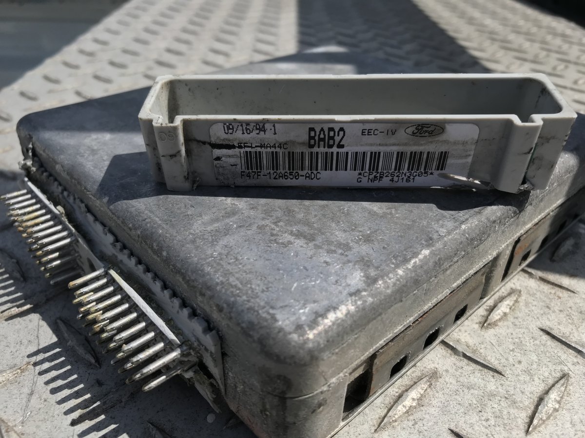

You're looking for the three digit code on the ECM that's in your truck. Kick panel, passenger side. Just post a photo of the bar and numeric codes on the 60 pin adapter.
No guarantee that it's the right one in there, though.
Typically, if you're having trouble with an EEC-IV, the electrolytic capacitors on the primary board shit themselves. They are typically only good for 20 years. Lots of instruction out there on how to replace them.
Is there a trick to getting the connector off? I tried unscrewing the bolt and it feels like the nut behind it is spinning in its housing. No budging from the connector
I had the shop hack the old one out. The new one (BGB) resulted in a no start. The ECU in the truck is ADC though. That’s a relief cause BGB is near impossible to find. There appears to be two ford numbers on the original computer. I assume I’m looking for the one on the sticker.
This is a good thread I found. I’m very pleased that he said ADC is the comp to get as it matches what came out of my truck
