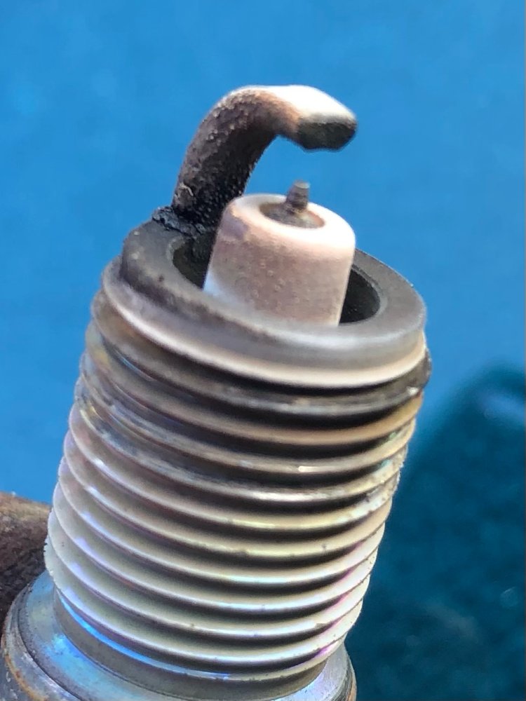

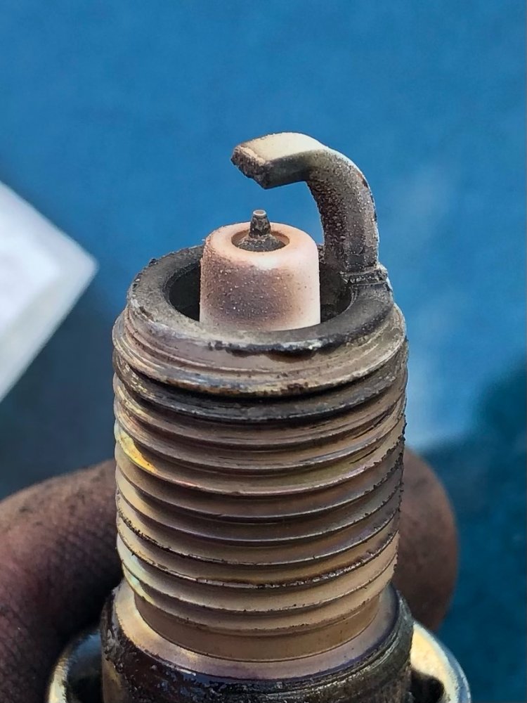

This weekend I plan to pull and inspect the plugs. Truck seems to be dieseling when going up hills.
