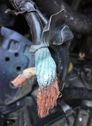

Battery cables can also corrode under the insulation.
