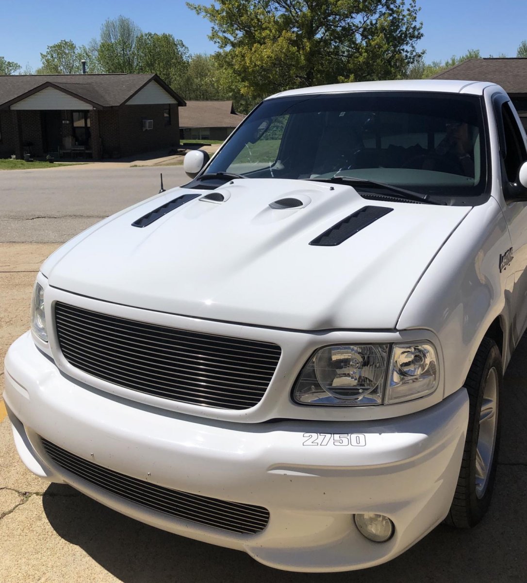

This topic comes up now and again at LightningRodder.com. One of the guys there, who is considered the "Expert" on Lightnings, says to "keep the clutch fan. It runs continuously". Electric fans are intermittent. For instance, both my trucks have heat vents on the hood. What good are they if the truck is idling and the fan isn't turning?
Also, don't know why this happened. Fitted my Lightning with an electric kit back some years ago. Fired it up. Temperature went up and up, hotter than it ever did with the clutch fan. When it finally kicked on, the controller and fan both caught fire. EEK!. Shut it off ASAP, and yanked the power wires off the controller. Fire went out.
Plus all the wiring was FUGLY.
NEVER AGAIN!!!

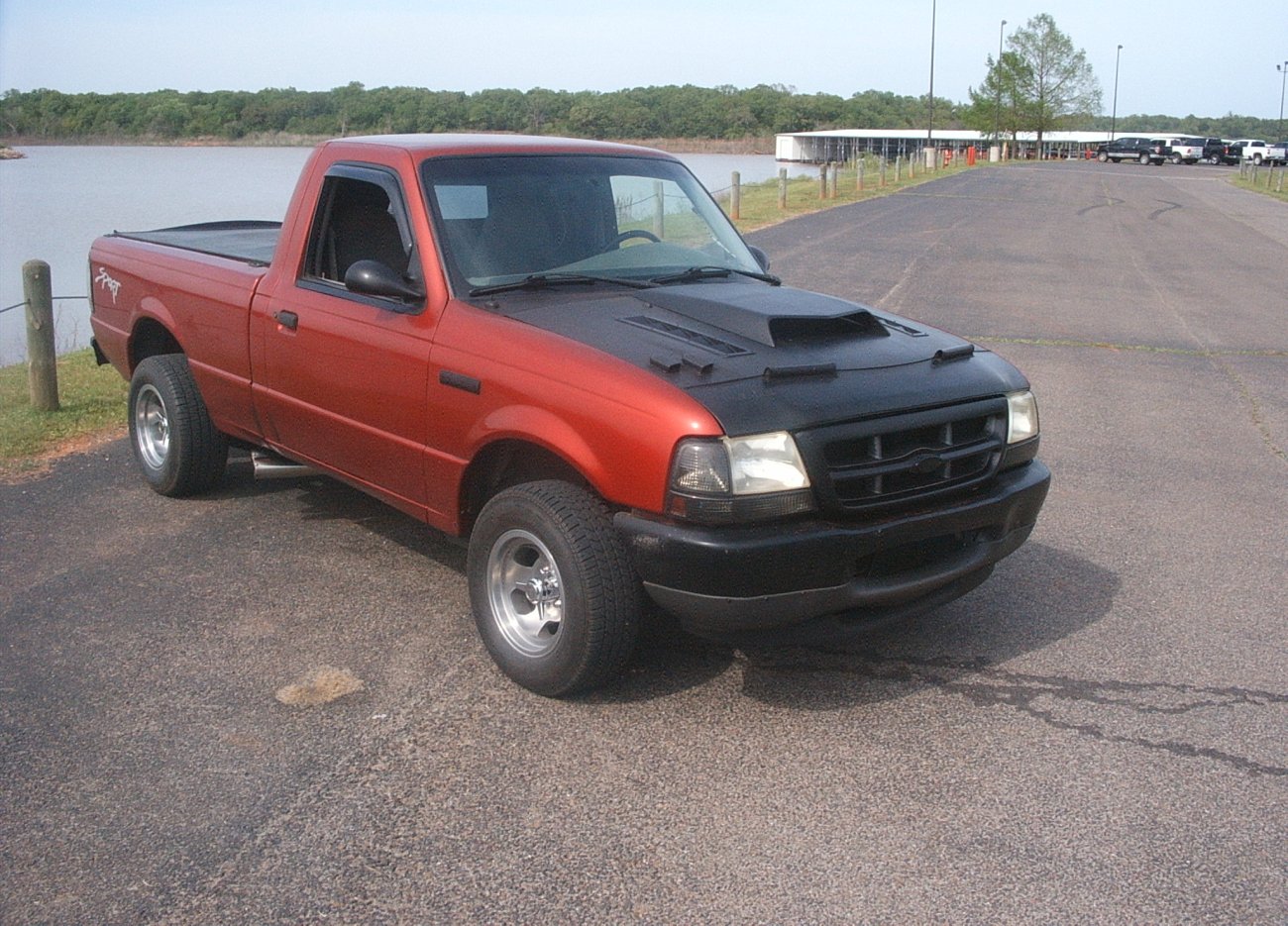

I have an e-fan on my Choptop. I’m not entirely satisfied with the situation but I think changes can be made that will make it more satisfactory. I never checked the amp load but the one I have doesn’t cause problems, actually because I’ve been fighting a heat soak issue, I leave the switch setup I made in the “auto on” position (it’s connected to a temp sensor) even after I shut the truck off and let it run until it’s cool. Of course I also have a 65 series battery. I set it up with a temp sensor control, an off position, and an always on so I have control over the fan.
