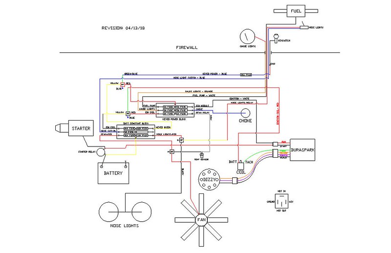

Post Duraspark swap you have a ton of brand new real estate on you passenger inner fender that very few other Rangers can have. IDEAL territory to run a wire off the starter solenoid to a fuse panel and go to town.
Me being me, I have a fuse panel over there that is constantly hot with the battery. Then I ran what is supposed to go to my ignition around the front of the radiator support (for cleanliness) to run a second fuse panel that is key power via a relay. From there one can really go nuts adding things.
I have my ignition and choke getting its power from the key power fuse panel.
I am working on updating my schematic as I have changed some things but this is what I have:
