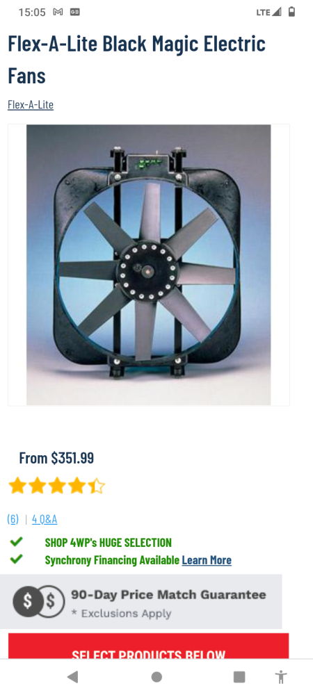

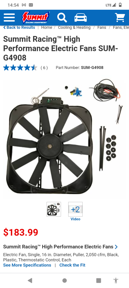

Here is a lower rated model that does work well; it includes a shroud and the controlling electronics. As pictured from "Summitracing.com", though also available from others sources; it is Summitracing's rebranding of the Flex-A-Lite Black Magic line fan. From memory, it is underrated, it behaved more like 2,500 to 2,800 cfm.
2nd pic is the nearly identical fan from a different source (4wheeldrive parts), says 15" @ 3,000 cfm.
Hey @gaz
Thank you for the recommendation. Is that model from Summit racing an exact fit or do I need to prepare to do some modifications to get it mounted properly?
Thx - rangergirl92
@Rangergirl92 ,
Yes, it will mount without issue or modifications and includes the shroud. You may need to be mindful of the crank pulley; I've heard that can be an issue (depends on radiator thickness, I'm using Explorer 2 core for automatic transmission), though it has not yet been for me in these Fords.
