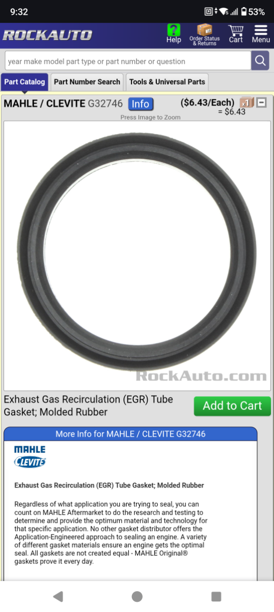

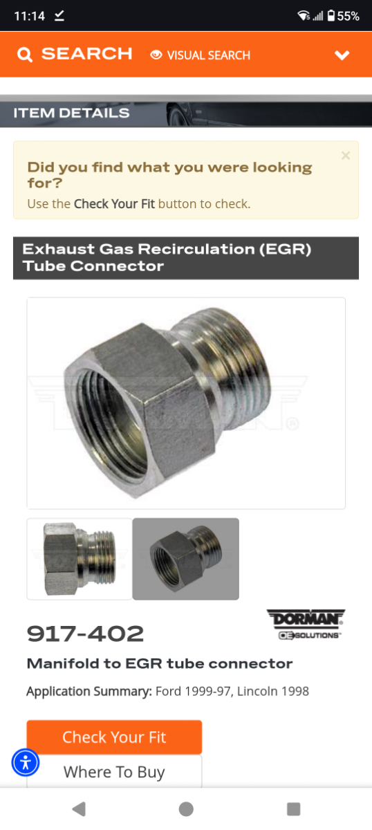

I found this. Don't exactly know what it would do.
  • EGR tube not sealing...
