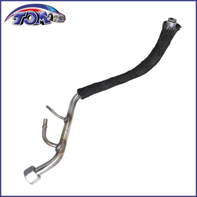

Hello Enthusiasts,
The EGR Valve of my RWD 1998 Ranger XLT 2.5L had failed. I was able to break open the bolts holding the EGR Valve with the manifold, however it was impossible to break open the EGR Valve from the EGR tube.
So finally I had to cut the EGR Pipe from the exhaust side. I am seeking recommendation for what are the possible options I have now ?
a. Shall I weld the EGR tube around the cut OR
b. Is there any high temp resistant epoxy which I can use around the weld
c. Lastly is there any aftermarket part with an exact replacement for the OEM ?

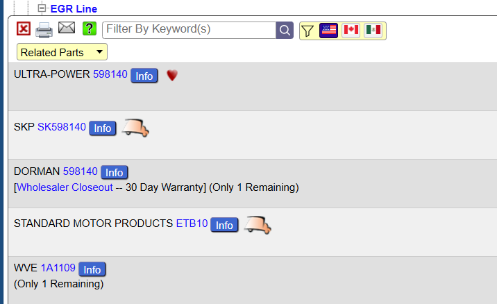

I read that the dorman tube isn't matching the size of OEM, below are the possible options I found on Rock Auto and I have found one from ebay with good sales number but it looks like this ebay item is dorman part too.
Thank you for your time.

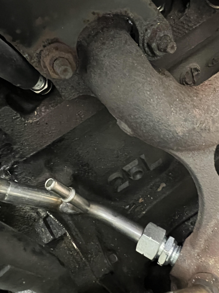

I was able to source an OEM EGR Tube luckily, but fitting the pipe has been challenging. To me it seems the EGR pipe fitting ( Aftermarket Dorman 917416 ) needs to be tightened further so that I can align the pipe with exhaust and EGR valve. Image attached, Please comment.

Did you do as I recommended and lubed the threads and started both ends before tightening starting with the exhaust side? Does the fittings feel seated and tight?
If so, then you are good. The union going into the manifold looks like it could go in more but if it's seated and tight, it should be good.
I can't add much more than stgsandman stated. Some of those aftermarket EGR tubes are not bent properly, or they get bent during the shipping process along the way. I started the threads on the manifold, then started the threads on the EGR valve, then bolted the EGR valve to the intake and torqued it down. Then I finished tightening the EGR tube fittings.
I was finally able to complete the job, the union which goes into exhaust had to be tightened further, after that I was able to fit in the OEM EGR tube. Thank You
