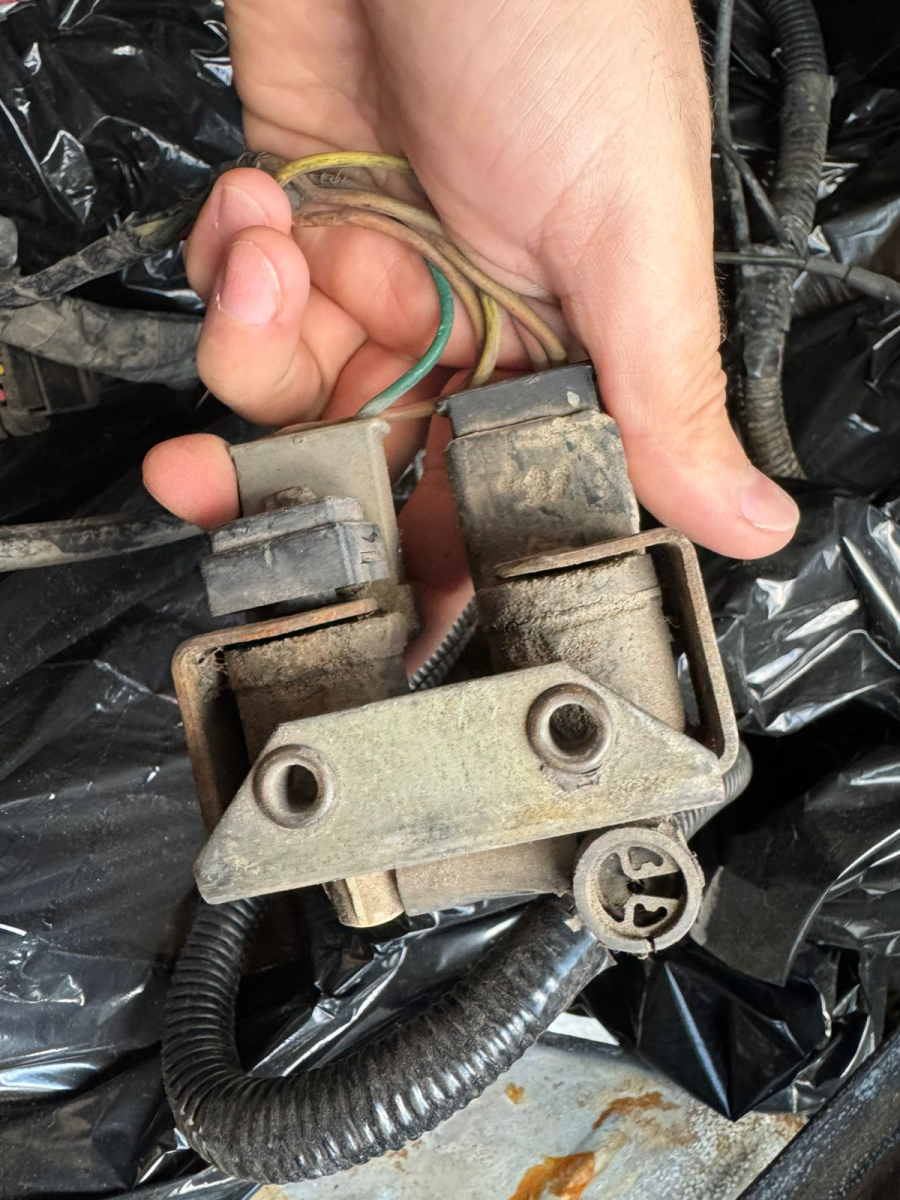

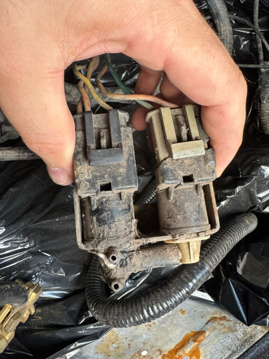

Hi, everyone. My truck has the EGR system disconnected, and it's working without any problems. However, I want to pass the smog test, so I'm trying to make the EGR system work again.
I have the EGR solenoid - as shown in the pictures - but it has no hose connected to it. Both electric connectors, grey and black, receive a 12V while the truck is on. I jumped it with the truck battery, but it does not make any sound, so I'm assuming it's not even working. Does anybody have any idea how it is supposed to be connected to the EGR valve, and if I can replace the old solenoid with a generic one? I already bought a new EGR valve with its position sensor and connected it to the intake manifold. Any help will be highly appreciated.

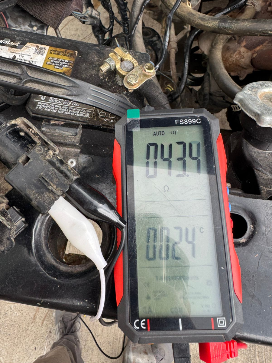

Both terminals on each connector have continuity

I'm not sure how it does what it's supposed to do without any hoses connected. On my 94 the solenoid opens or activates when the engine reaches a certain temp and allows air flow(?) from the canister back to the engine to burn off any excess gases - I get that this is primitive explanation and is prolly at least half wrong - but the experts will be along and jump in to help more. So with no connection to the canister via hoses...? I am just as curious to find out as you.
R
R
That's exactly the issue I want to fix, hah; I want it to work as it should, but since it's not connected, it's doing nothing. It is just that I don't know where each hose should be connected to
My later one doesn't look anything like yours, but in a general sense the solenoid needs to connect vac source and the EGR valve, right? And if you have whatever predated a DPFE sensor, IIRC it's got a single hose to the exhaust shunt.
EDIT: Pre-DPFE was just "PFE", but I don't believe the Ranger used one? I only see EGR valve position sensor on the parts list.
There "should" be a vacuum routing diagram under the hood on the radiator support that will show the red and green vacuum hoses that would go to that, I don't remember but I think red is manifold vacuum and green goes to the EGR valve.
There is not; i guess the previous owner took it off. I´ll look for the diagram online tho. Thanks
If I get a chance tonight since no one else has chimed in I'll see what my '90 has for a diagram, I think it still has one, the '92 I have in the yard might too... the vacuum should be the same on those as they just had a EGR position sensor but otherwise I think it's the same.
@Eduardo.lodela ardo
The top vacuum nipple goes to the EGR valve, the lower nipple goes to the intake manifold connection tree.
