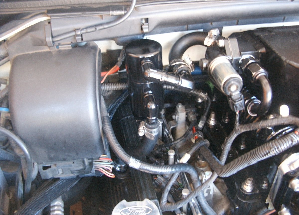

The PCV system on the Lightning causes a lot of oil in the intake above the blower. The blower and the intercooler end up being caked with oil from the PCV. That's why some guys delete it. Others like myself install an oil separator in the line between the PCV valve and the plenum to capture that oil. I removed the blower and intercooler from mine in 2019, cleaned up the intercooler, which I could not see through from all the oil in it. Installed a Magnum Powers blower and an oil separator. Been good ever since. Just have to remember to put a rattle can lid under the thing and crack the valve every thousand miles or so.

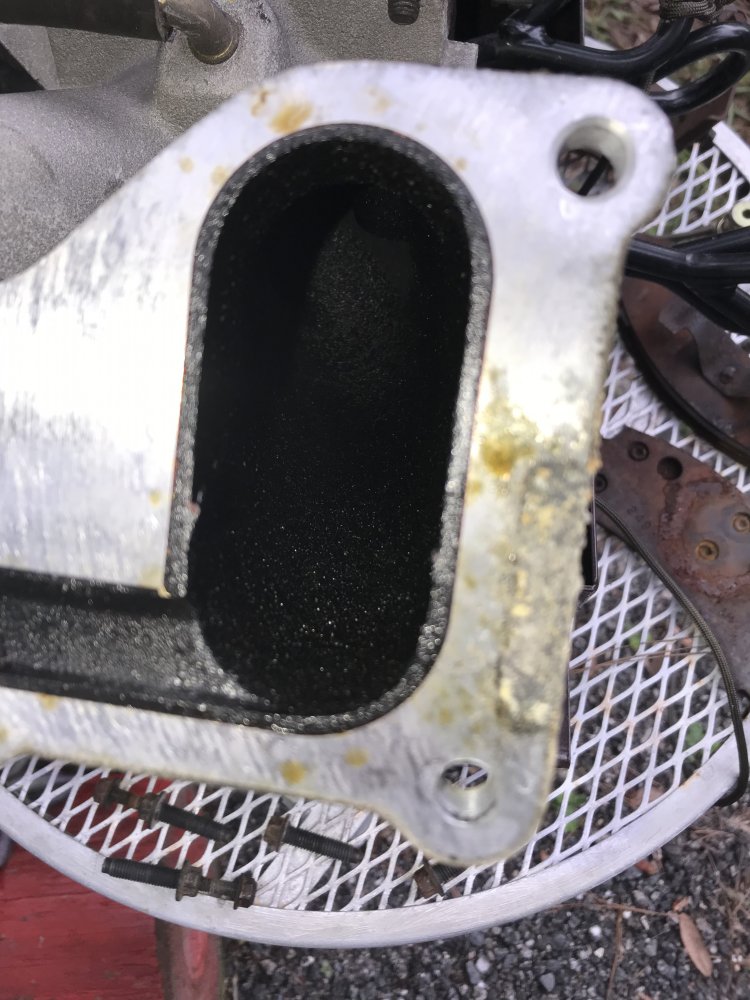

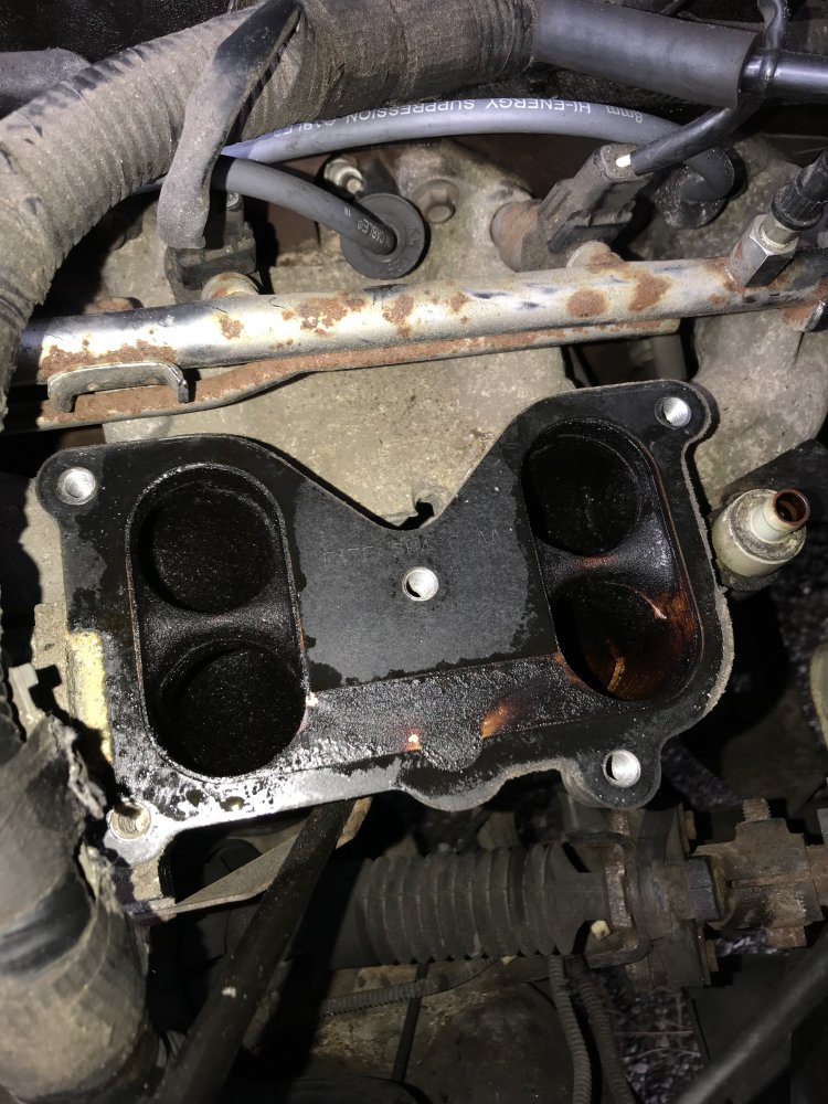

I ordered a catch can for my ranger. Got a $20 Chinese one that looked like a copy of some high dollar brand. The intake manifold was pretty filthy, but I didn’t bother cleaning it. Might consider pulling the top half again and scrubbing it. The bottom half looks a bit more involved to remove tho.
64621
64622
Catch cans are a good workaround for forced induction, especially if the inlet side of them is at the bottom and they are above the valve cover like yours then they are self draining, yours the inlet is a little high up so it will hold some like you are seeing... The oil separator on a 2.3L isn't quite sufficient to pull the oil out...
That's pretty dirty, but likely from the EGR and oil mist.
