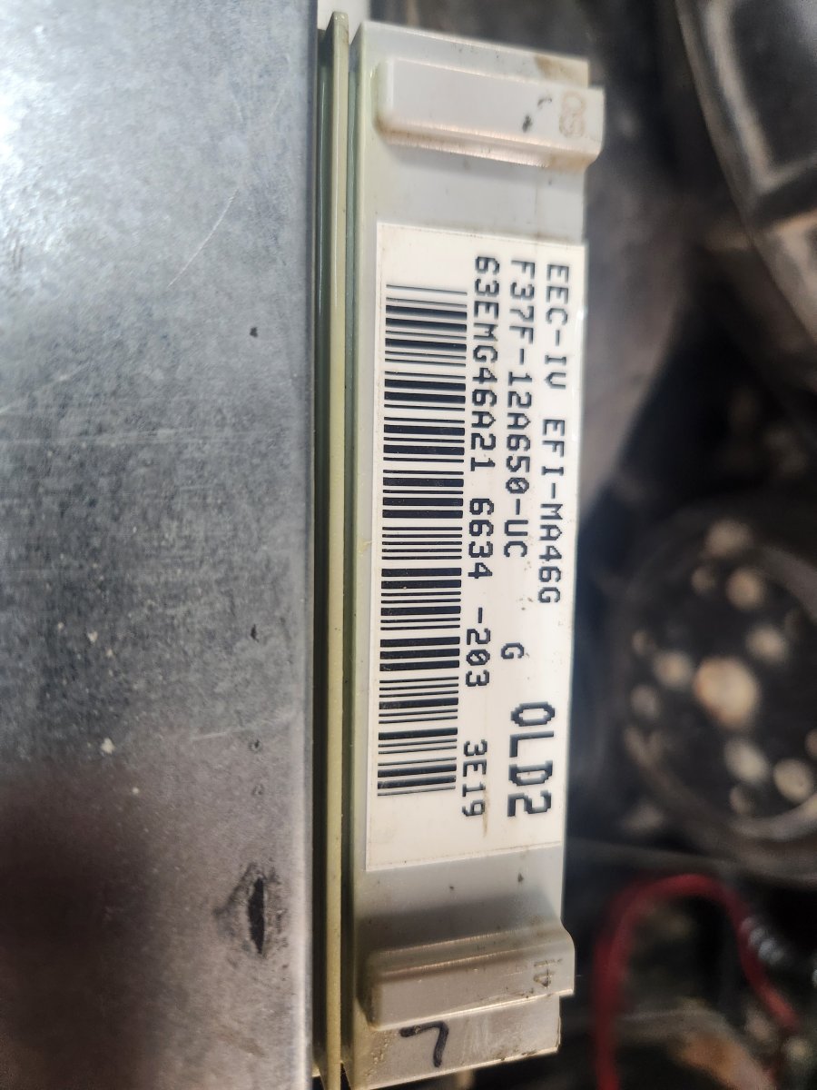

I have a 93 ford ranger 4.0 manual no egr how do I find out what computers are compatible so I can get one out of a salvage yard....

Ok so any one would work that's a 93 4.0 4x4 but sense I put a manual shift in mine would the 4x4 4x2 part matter?
2WD vs 4WD shouldn’t matter. The ECM doesn’t have any control over the 4x4 system.

Why does the salvage yard tell me only 2 other computers will work what would be so different min is a uc .. and they said vb ... and Uber will only work wtf any ideas
salvage yard is using a database like Autodex North America and it is super super exact. They will only list the exact same part number. So if Ford made a part and gave it part number XY-1234, then 5 years later improved it and replaced it with a new versions XZ-1234 (note the Y and Z), the junkyard will still tell you ONLY XY-... and not give you vehicles with the XZ-... parts.
Not to mention a XL and XR both work perfectly fine, that is just the slight version different that Ford used in a CAR/SUV that had one additional feature that doesn't exist on ours and the computer ignores missing with no errors.

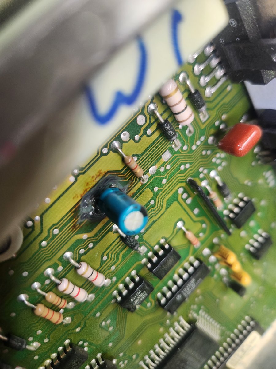

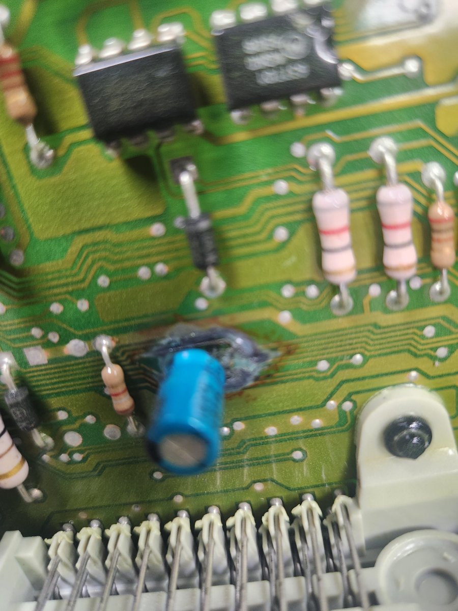

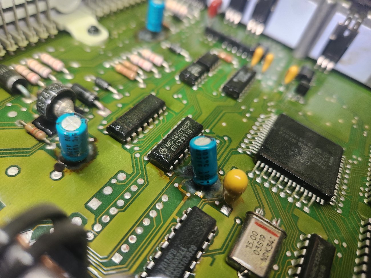

Ok I didn't know how that worked i thought I was screwed thanks for explaining so i just need to ignore them and just get one for my year n manual transmission.... tho that motor is a salvage motor and was out of a automatic n I was getting a natural switch code but I couldn't find the wires .... then I started getting the ecm 511 i think code pin 1 something I pull the computer out n seen the board burnt under the blue chips
you can cleanup and re-cap (replace capacitors) for little of nothing cost...
Yea I grew up working on chip boards but the board is burnt under all the blue ones

In both 93 and 94 Ford produced 2 different 4.0l setups:
• the SFI-MAF/EDIS with EGR (the California emissions, sequential fuel injected version)
• the MPI-MAF/EDIS non-EGR (the Federal, batch fire version)...the PCM from one system should not be used on the other.

Well idk what I got i ordered the F37F-LA from a salvage yard yesterday
