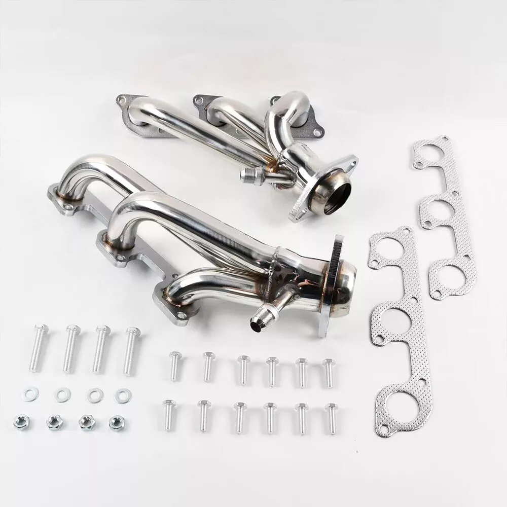

Saw this the other day, regardless of the quality for the price how can anyone go wrong. There is a video of some kids installing these saying that they had issues with the stock exhaust interface at the "donut" gasket. It's a little roadkill style. Header install video. What's your take? Do headers on the 4.0 dog really make a difference, I know mine runs pretty good, but the exhaust system is up for replacement within the next year or so. I've installed "tubes" before & realize that there may be clearance problems. So with some small high flow cheap cats, a couple new O2 sensors, some welding, maybe a trip to my muffler shop. Was never into anything V6, just V8s. Carblubberated.

Headers on a stock motor does not produce must of anything. You would be better off getting a highflow cat-back and a cold air intake. If you ported your heads, then headers would be a nice upgrade.

definitely old school flat flange classic headers suck and leak....
good headers do not leak. until they crack. just like any other manifolds.

on old flange style headers, cut the flange between ports, each port will seal better as the flange warps making it difficult to seal the ports.
I say get them. I have bought the cheapest ebay headers for old jeeps and they were great.

I've never had an issue with ebay headers, currently running a 100$ special on my '96.
I HAVE however.. had problems with 750$ headers made in the USA 🤷‍♀️
This reminds me... I gotta re-torque the header on the '96. It's seen enough heat cycles by now.
Just be careful if you about the equal length headers. I have a set on my 2004, and they run so close to other parts that I had to insulate the area or move wires and hoses.

More or less.. the longer the primaries are.. the more top end you'll get. Shorties are for torque.
long for tq
