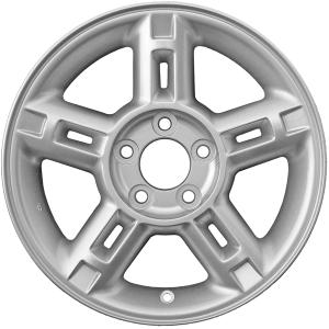

My Dad has a pretty nice set of tires and alloy OEM wheels off my brother's old '95 or '96 Explorer. But they're 16" and I think the wheels are off a newer one - probably 98+. Whoever sold him the wheels and tires used wheel spacers on it.
I could get them cheap, but anyone know if they'll fit on an '87? I'm not a fan of wheel spacers and I read something about the hub hole being too small on the later wheels. I have the manual locking hubs on the front of the '87.
I believe they're these wheels:
I wouldn't mind a new set of tires, but my wheels are 15" so those tires don't do me any good without the wheels. They'd fit my Sierra, but I run higher load rating tires on it since I tow/haul a lot with it.
