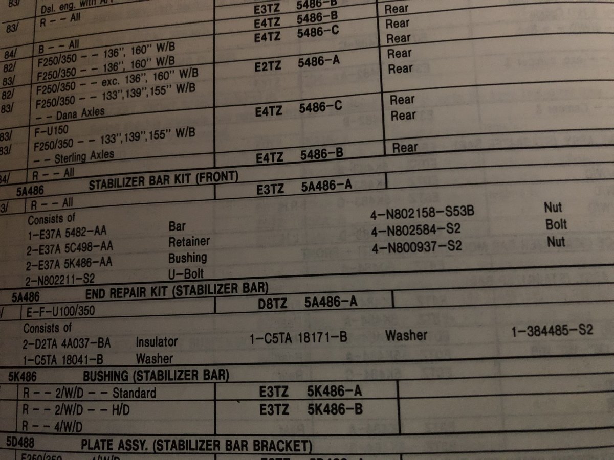

In this case, N802211-S2 U-Bolt (x2) and E37A-5C498-AA Retainer (x2) are the parts I'd like to try to get, and then I'd feel comfortable just using normal grade 8 stuff off the shelf for the rest.
The bar is including the bushings at the crossmember, and it looks like the bushings at the radius arm are still commercially available (and if not, they are similar enough to many other sway bar bushings that I could make something work).
But the correct dimensions, shape, and hardness of U-bolt will be hard to know for sure, so that's where OE hardware is nice.
The E37E is a drawing number, the original service part number would have probably been E3TZ-5C498-?, but I can’t find it in my book. The part number had also likely been superseded over the years. You’d likely need a microfiche reader to find the correct part number.
Now why are you looking for this particular sway bar?u having clearance issues with the front of axle one?
Pictures have the base part numbers, you will have to play around to get the engineering codes and suffixes to line up.

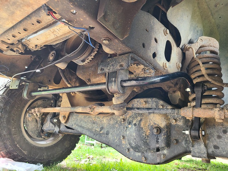

It isn't bad on a 4wd, what I think you call a dowel is the stud that holds the spring in, brackets wrap around the beam and that is it. I swapped in a later axle that had all that there, snagged the frame brackets off a later scab and ditched the behind the axle setup so I can pull a link and disconnect the sway bar on the trail. I would think 2wd would be similar.

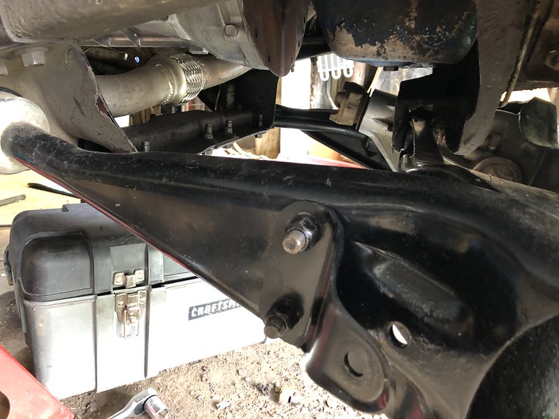

I'm hung up on this specific bar because the early trucks do not have provisions to install the front-mounted bar. Not only is the bracket on the axle beam missing, but there's no way to mount it without alterations:
These peg/dowel things are in the way. I've tried to make them move, and they don't want to, so it's not clear to me that they're removable.
Obviously with a grinder, anything is removable, but I was looking for "easyish" here.
