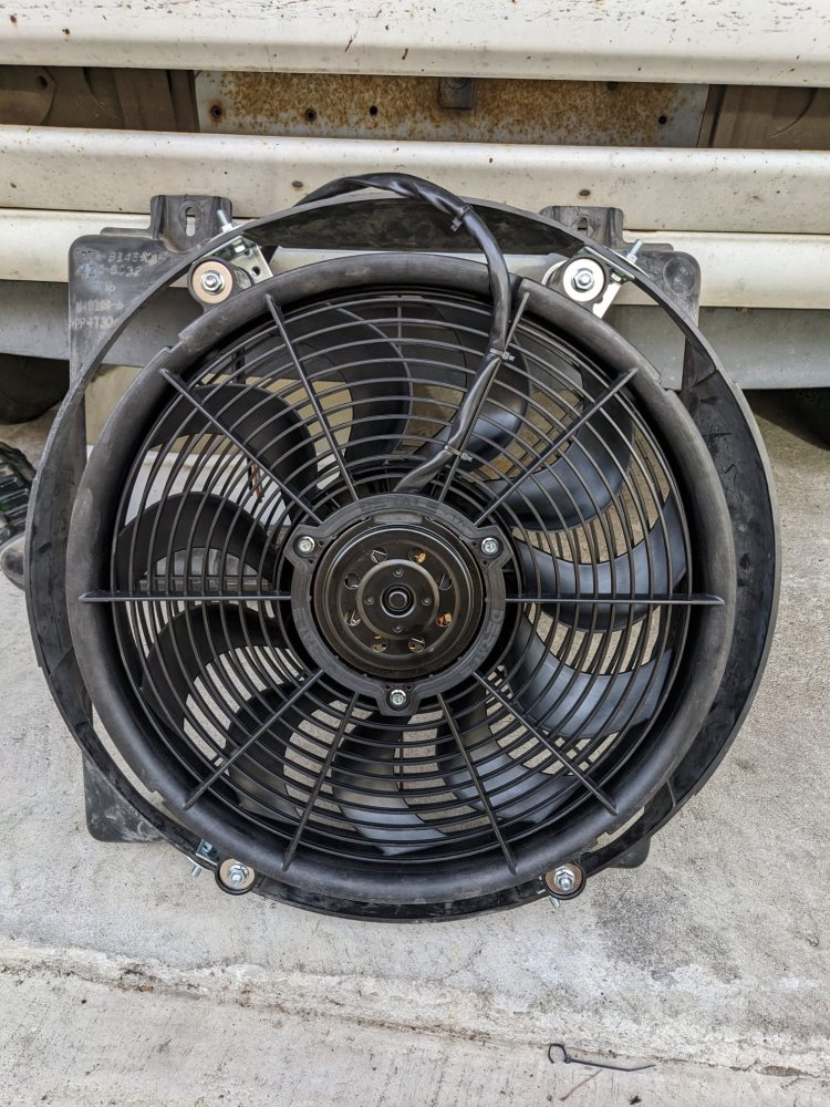

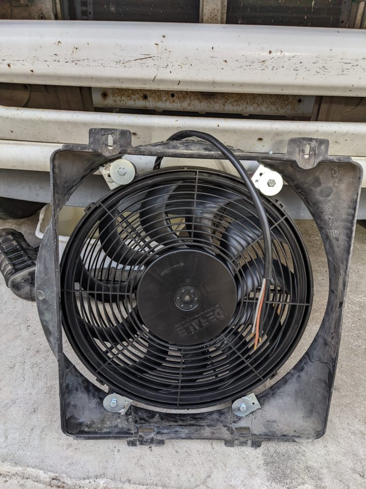

Got the Big 3 finally finished and mounted the fan today.
Its going to do a lot better job of pulling air through the radiator if you block that opening around the outside of the fan housing.
I'm gonna be curious on how well that works.
How close to the radiator is the fan?
I like that much better then running zip mounts through the radiator.
Agreed. My original intent was to find something that I could cut to fit the gap and bolt in between the mounts. Not sure what kind of material I will use. I *might* try it without it and see how the flow works as it sits now.
Same. I have high hopes as it has less pass by airflow than the stock e fan on some Rangers.
I'd say an inch or so? I wanted to flip the brackets around and recess it deeper, but it won't quite fit that way as the circular section transitions to the rectangular dimension a bit too soon. If I did more modification it might work, but I think diminishing returns at that point may make it not worth the time and effort.
Thanks! Me too. Zip ties are tried and true, but I worry about just how well those tiny fins would hold the weight of the fan over time. In my opinion, could cause early rad failure. Though that's just speculation. Haha

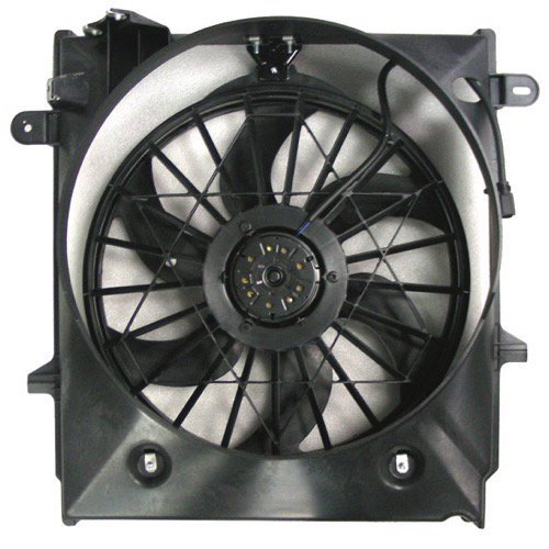

Case in point, here's a stock Ranger e fan on a later model truck. I did notice that it is MUCH closer to the radiator though. Possibly touching. So the extra space around it may not be as much of an issue as on mine.
That space around it comes more into play due to the gap you have between fan and radiator.
That makes sense. As since mine isn't touching the radiator it could allow the air to pass in from the engine side of the fan instead of through the rad.

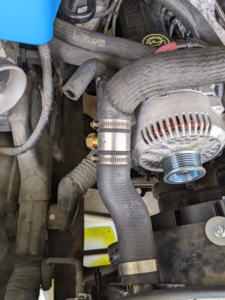

Went with the upper rad hose for my temp sender. Fit nicely under the intake tube when I test fit. There's just enough straight section in this part of the hose for the adapter and this will keep it out of the highest section. Here it is about level with the top of the radiator instead of above it as it would have been if I would have installed it further up in the hose. Hopefully that will ensure that it stays in the coolant even if it does get a bubble in the hose. Need teflon tape or I'd have the sender itself in too.
Thats nice work, Ive been taking notes. What made you go with Derale?

Thanks man.
Size worked for my fan shroud, pulled a decent amount of air and the current draw seemed to match air flow claims. I read somewhere that current draw *can* be a decent indication of actual flow rate, which makes sense imo. Also it was sold by Summit which I am partial to over Amazon as I have had issues with quality control from Amazon in the past. All in all that is more on the supplier and less on Amazon as a whole, but peace of mind and whatnot, I suppose. Lol Price was decent too comparatively. They also sold associated relays specifically for the fan. Reviews were mostly positive so that didn't hurt either. But there could very easily be better options out there that I missed or passed over.
