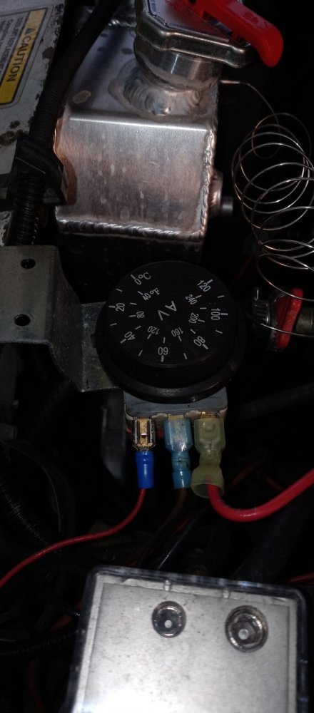

I built my own simple e-fan set up. I bought a flex a lite black magic fan years ago & used it on another car that i sold, but kept the fan. I used a thermostat control switch from ebay, comes with everything needed. Relays, wiring & dial type thermostat. Install was simple too. Mounted it on the rad support right next to the rad & battery. I took the temp sensor probe & stuck it between the fins/tubes on the rad, next to the upper hose area. I turned the dial all the way up, started the truck & let it get to halfway on the gauge & turned the dial down until the fan came on. It works perfectly this way & i can turn it up or down if needed. Its been on the truck for about a year now. I also upgraded my rad to a 3 core aluminum unit & added a separate trans cooler. I put almost a 1000 miles on the truck in one week last summer & it was fine the whole time.

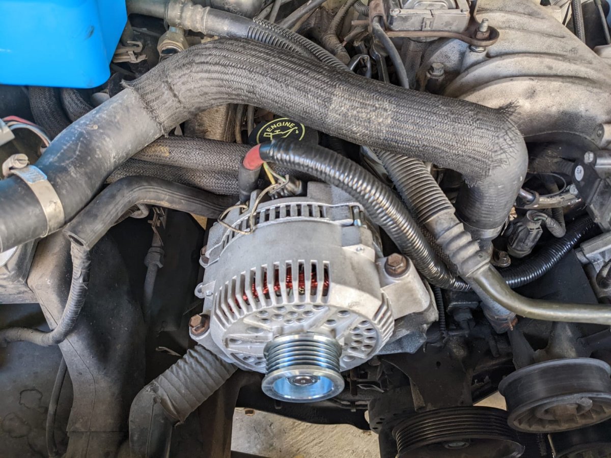

I suppose it's also worth mentioning that I'm upgrading to a 130A alternator and doing the Big 3 in conjunction with the fan swap.

About three quarters of the way through my Big 3 upgrade. New 130 amp alternator as well. Had to put it on hold yesterday as my heat shrink didn't fit the wires so I had to go to the store and grab some more this morning. Cleaning up lots of connectors and contacts in the process. Will probably clean up some grounds before I'm done. The hardest part was figuring out where to mount the circuit breaker. Lol Ended up bolting it under the fuse panel.
