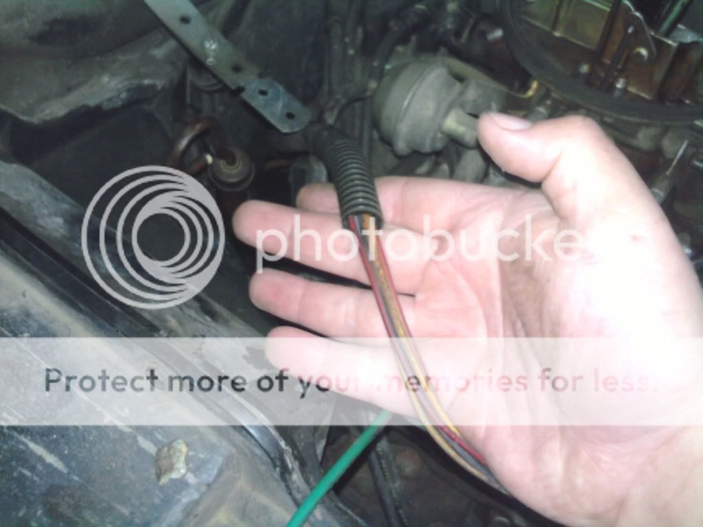

OK so i have started my duraspark install and hit a snag
What does this wire do?
It goes down behind the firewall.
And can i take this thing out?
Thanks

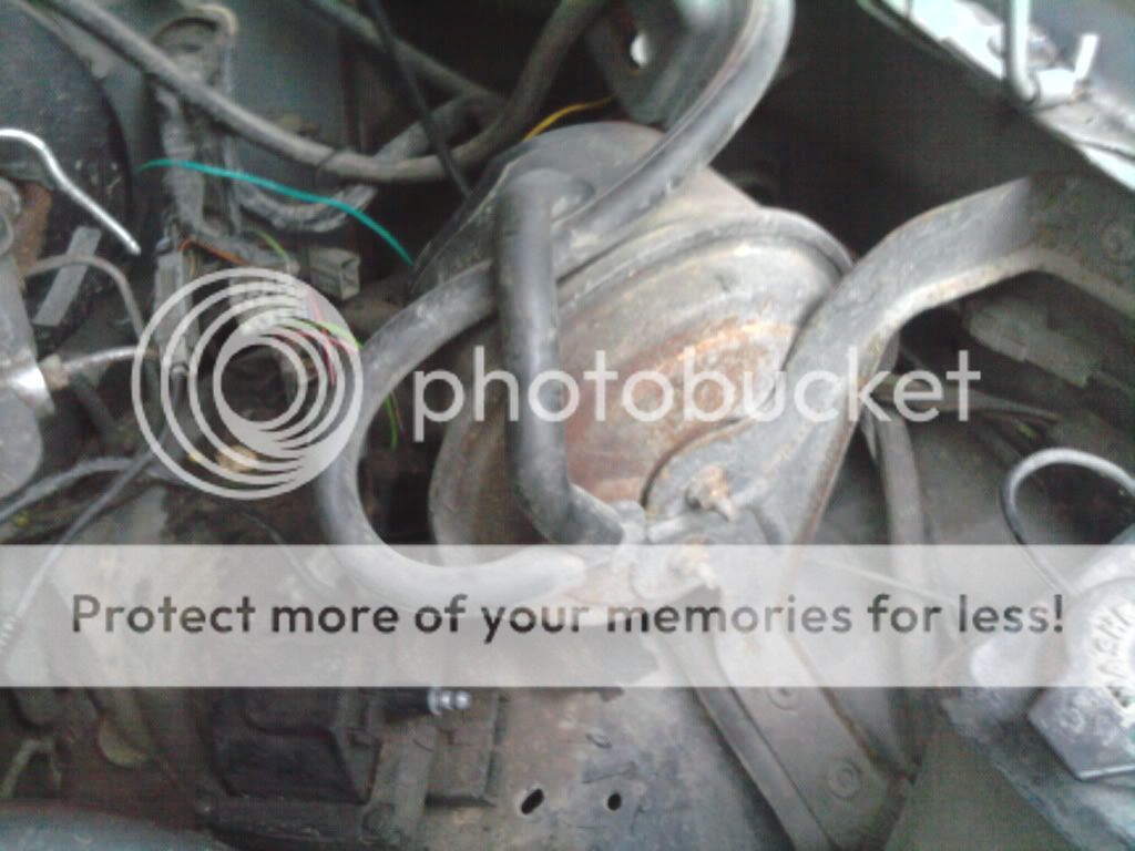

Can you trace where the wires go and is that for the cruise control with what look like vacuum lines.
I was thinking it was cruise control. there is a cable that comes off the back that is not hooked up. I can trace it and get a pic up
The wires go to above the transmission.
I am guessing the cable went to the throttle kinna looks like the one on my jeep. Did you get rid of all the emission stuff maybe those wires are for the O/D if you have it. Someone here will know by the pics. I have a 83 ranger and only had to splice one wire for the ignition, the green to the coil I got the harness for the dizzy from a 84 4cyl ranger. I wanted it plug and play ready. For your truck you can do the same you just need to cut and splice two wires for the power to the module if your going with the stock coil.
i do have overdrive. So i can just take the round cruise control thing out? If anyone else could chime in i would like to get this done tomorrow but i dot know about those wires. I cant see where it goes or find it under the truck.
I am pretty sure it is not for the ignition dont cut any wires you dont know where they go. Any wires you do cut leave them long enough to splice later if necessary.
thats the ones i cut, they go for your backup lights, t/c lockup and neutral safety. leave those in tact, i couldnt get mine out without cutting em so now i get to wire them back up
Alright cool, those get left alone. So can i take out eh Round tub thing?
If it dont work and you have no plans on making it work yea pull it and plug the vacuum lines. The first thing I did was remove anything not being used wires, vacuum lines, sensors, solenoids. I hate loose wires the only wires I needed to cut were at the 8 wire connector by the coil. I cut the computer power wire but left the power to the coil and cut the coil neg wire and spliced the green from the module into it. With the 83-84 power to the module is just plugging it in the colors are backwards but is correct. 85 takes two cuts and splices to power the module correct but real easy once you understand it.
