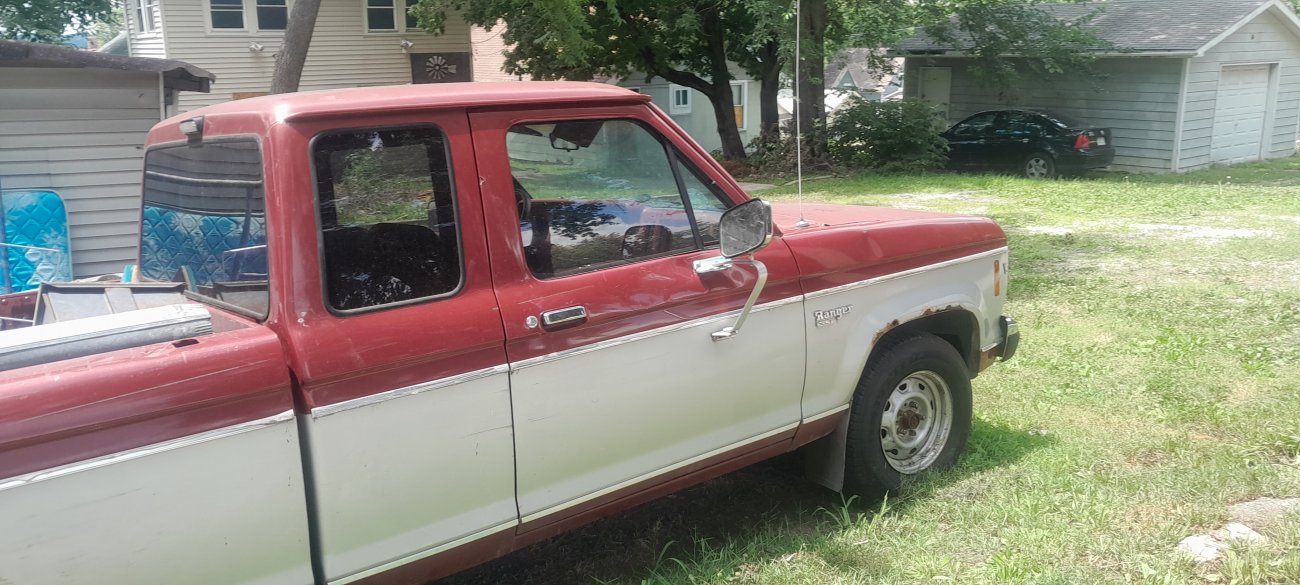

I have an 86 2.9 V6 automatic extended cab with 2 tanks and a switch to switch between.
