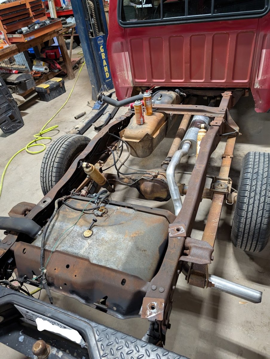

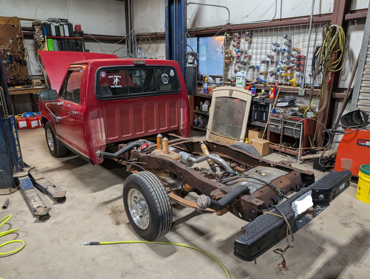

I just went through fixing the dual tanks on my 83. Had to replace the selector valve and replace all the lines, vents, etc. I think they changed up the senders for 85 through 88 dual tank trucks so they may be different that the first year trucks too.
If you have a good rear tank take care of it because you won't find one for sale ever. I think the only reason mine survived is because old diesel doesn't rust out tanks like old gas will.

I warn you it isn't a cheap or easy path to go down. The only reason I fixed my duals is because I plan to add warming coils to the rear tank and run peanut oil, cooking grease, etc. My little perkins is going to smell like deep fried fast food going down the road. Plan is to start it up on the front tank with regular diesel then switch over once the grease is warmed up.
