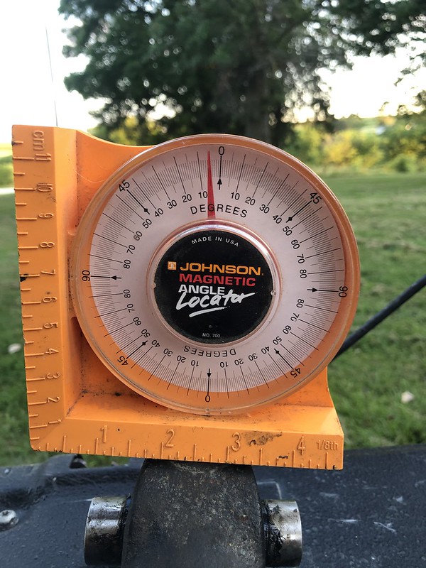

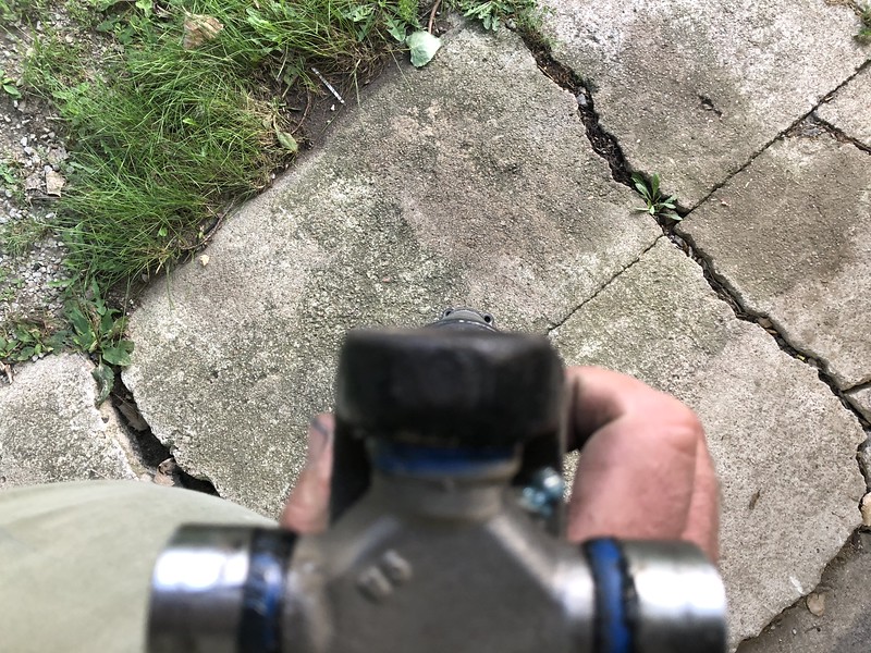

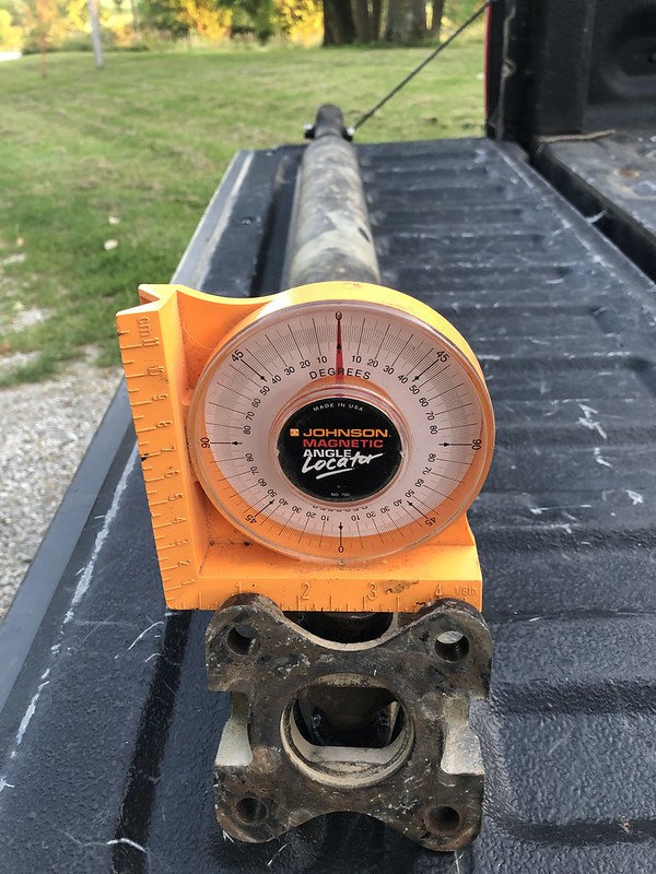

I have been chasing a vibration under hard acceleration ever since I did my transmission swap. I found some of it was my driveshaft was a hair too long and it was bottoming out so I had it shortened two months ago. I pulled it out again last night and noticed the yokes were not clocked exactly the same.
Looks like a shy 5.5 degrees off.
The confusing thing is the first driveshaft I had made when I first did my V8 swap was off more and didn't vibrate under hard accell so I don't know if this would really be my problem.
It is just a single piece telescoping driveshaft, no carrier bearing.
Is there a spec how far out it can be?

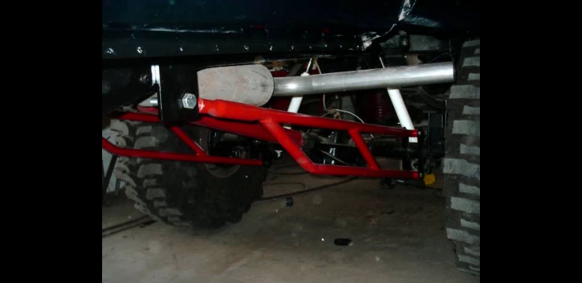

Didn't you go pro it before and see it wind up.... maybe try to go pro again.
lol, the first thing I did was change out the whooped springs for Explorer springs thinking it was spring wrap. Also deleted the lift blocks in the process to help eliminate spring wrap.
You might need something like this... maybe you do already if that is the case maybe those joints are defective.
