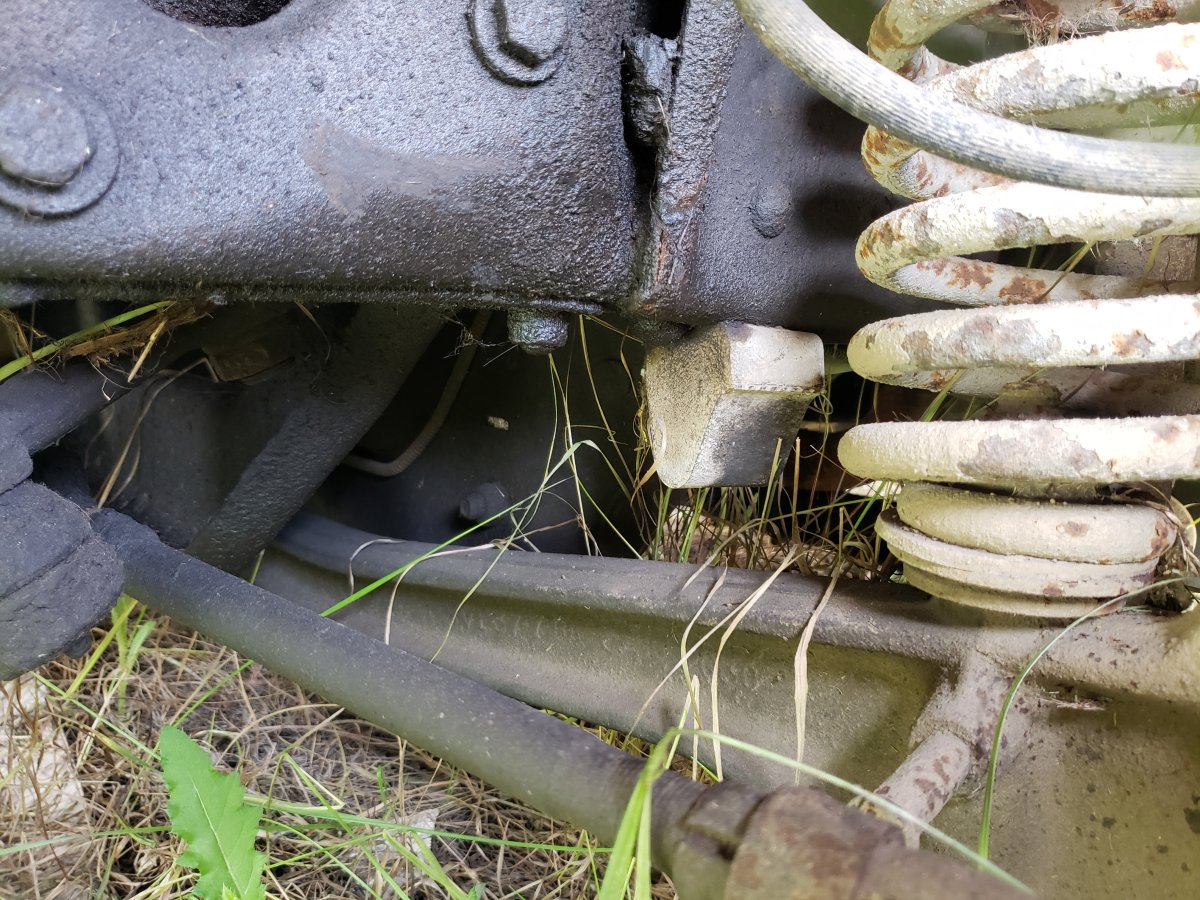

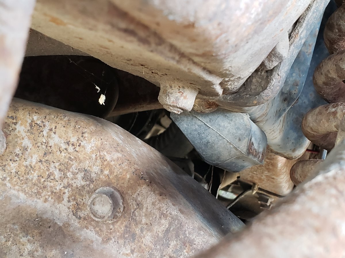

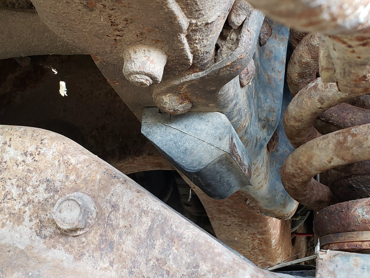

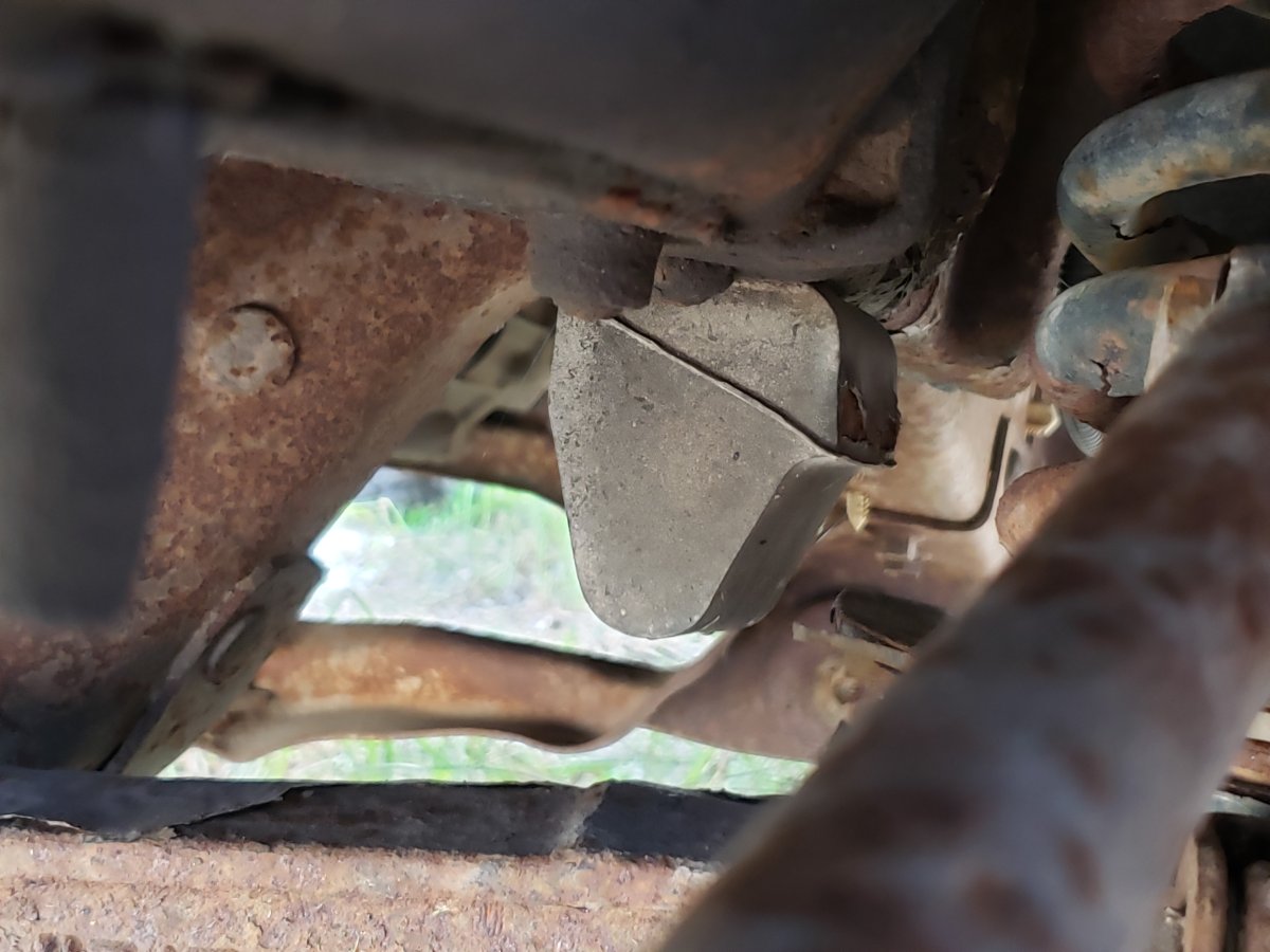

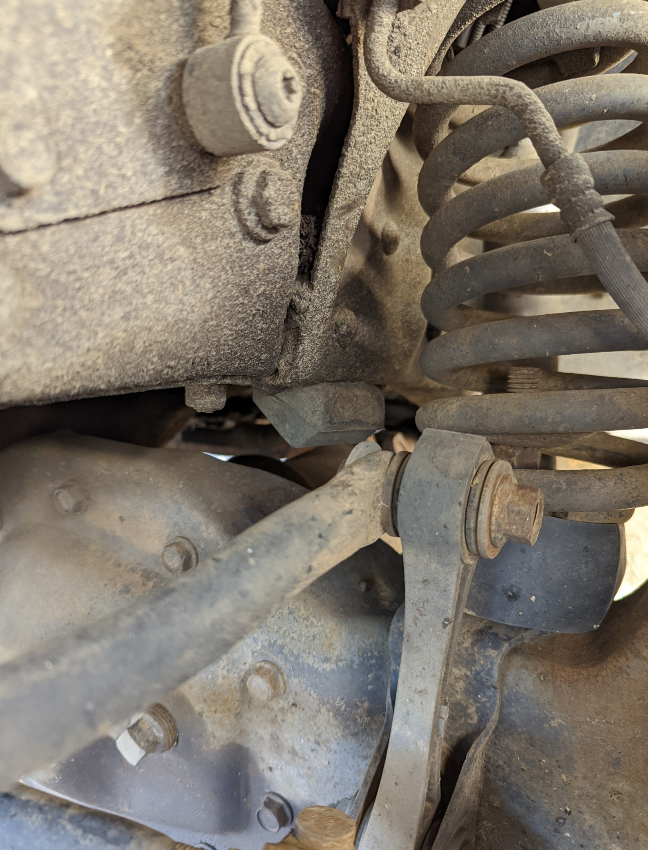

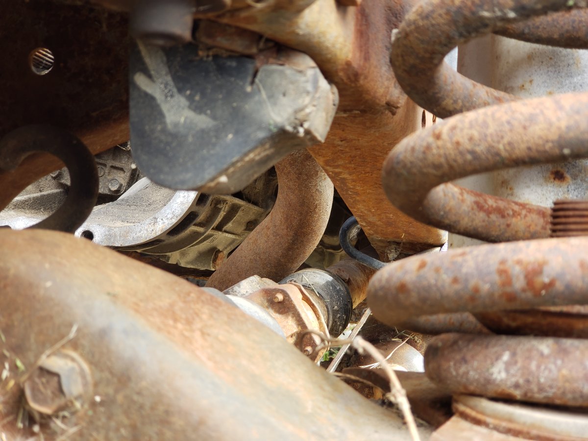

That is the style I remember as being the longest. I thought about chopping it down, especially the side metal piece but found another shorter one.
86 2.9l 2wd
93 2.3 2wd
93 4.0 4x4
91 4.0 4x4 no motor, unknown source of bumpstop
Wish I could pin your post to be the top google result for bumpstops; that's exactly what I wanted to see. Vehicle 3's axle position looks just like mine. I wonder how much dampening those bumps even do, with so little "jounce" before the metal bracket "stop".

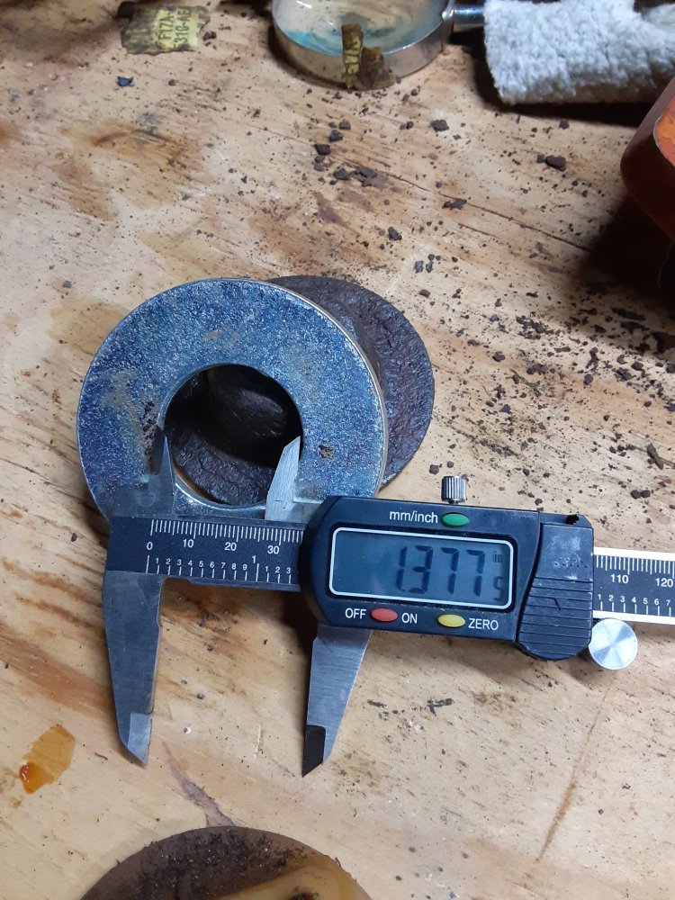

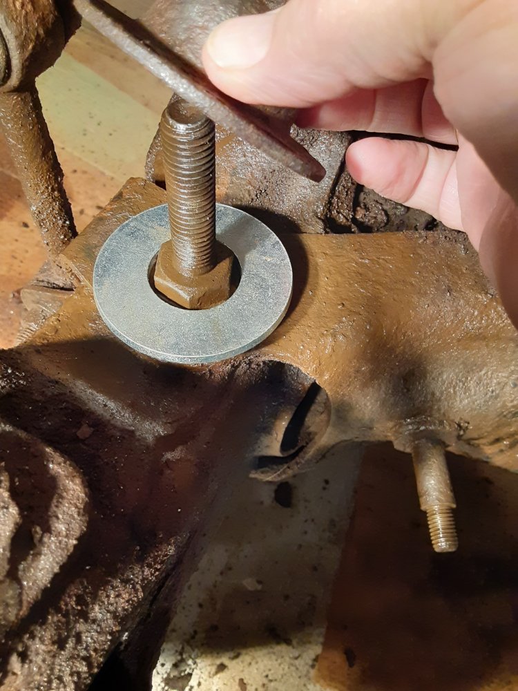

I don't see any reason not to ride on my cutoff as-is for now unless a hard hit snaps the bolt or something. Now that we've confirmed the 4x4s are shorter, I'd also be comfortable buying new, but I'm at least gonna wait and see if I need countershaft shims in my trans, rather than killing my wallet on shipping multiple orders.
EDIT: So for future reference, I didn't end up buying a new bumpstop. Now, a month later, they're marked "discontinued", so clearly I missed the boat on that one. Hope the modified 2wd holds up, or I guess I'll have to fabricate something.

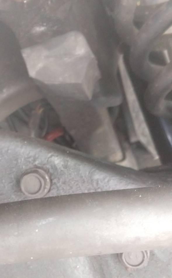

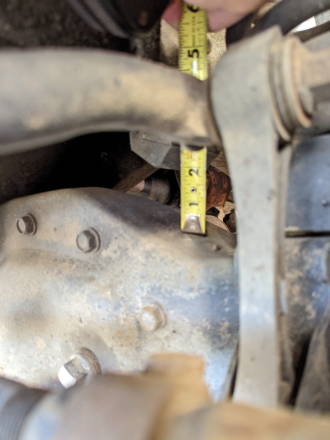

Could anyone with the D35 TTB stock in their truck share a picture and a height measurement for the driver's front bumpstop? I feel like the stop in this position is different between 4x2 and 4x4, but I can't find any hard info. Thanks in advance.
I have 1.5' spring spacers on mind due to the springs sagging so I don't know how much this will help you. Sorry for the blurry pic. My phone didn't want to focus on the measuring tape.
Nice, thank you. Always good to have more pics & measurements.
