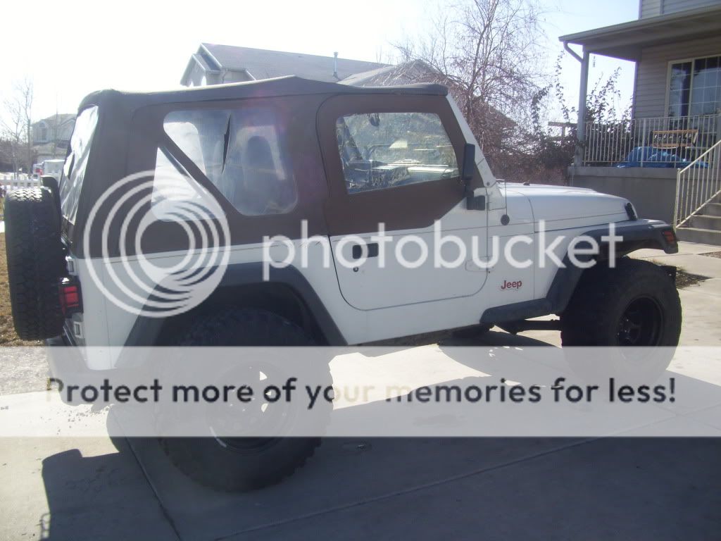

My 97 Wrangler's mirrors are on the doors.
