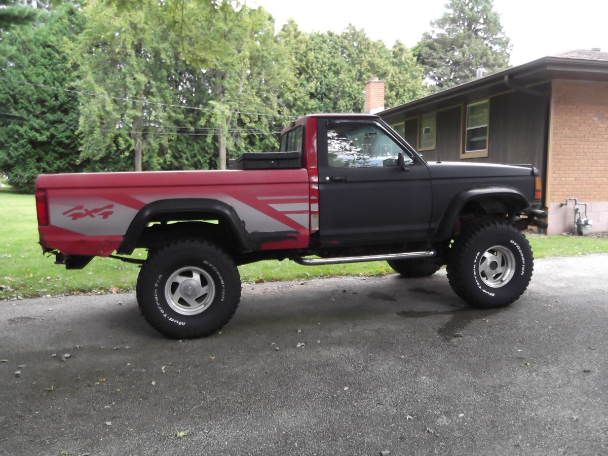

That's a serious lift on that truck and ginormous tires. What is the lift kit, and what else was modded besides the wheels/tires? How streetable is it?
Would like to see pics.
I think it is same gen as mine right?
Sorry, James Morse I don't have the Ranger that is in my profile anymore. I wanted to get something that is easier to get into, so I bought the 04 Ranger that is in the picture. I bought the 92 with most of that stuff already on it but I never did any off roading with it. The only improvement I did was, I was at the junkyard, and they had a newer truck than mine and it had a better gear ratio then mine, 92 was a 327 and the newer was a 373 with a limited slip differential. The only drawback was the newer rearend was a couple inches wider but with those tires that was noticeable.
