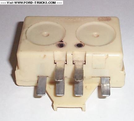

the "speaker" is probably bad. grab another one from the junkyard or Ford and just replace it. its under the dash, driver side, slightly toward the center.
looks like this:
60016.520.390

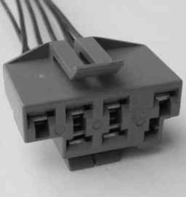

plug in looks like this:
looks like this:
60016.520.390

Okay well I went to the local pull apart and got 6 speakers. I got so many bc I wasent sure if they were going to work or not since they did come from a junkyard..but 3 of them worked. Hooked up the loudest one and it chimes just like a new one. Thanks for all the help guys.
