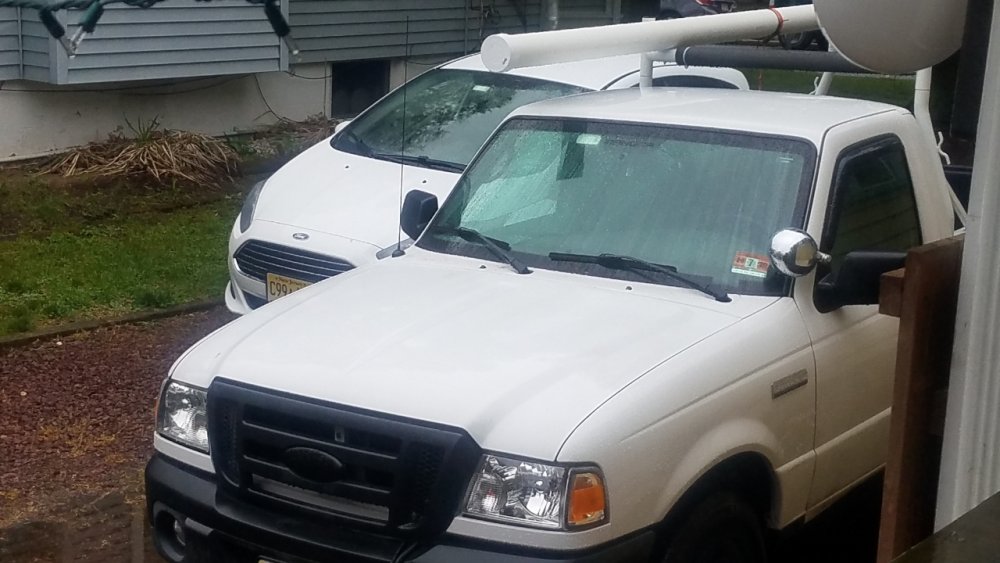

Just wanted to update. The old school turn the key on and off 8 times thing worked fine to program the fob part on the IKT key. I didn't cut the key yet so will report back if i can get the transponder programmed. My local ace hardware couldn't figure out how to cut the stupid thing so I gotta find a real locksmith. :rolleyes:

All done and 100% working, just got it cut. The transponder programmed easy. Insert key 1 and turn off and on, insert key 2 and turn off an on, insert new key 3 and start the car. The new key works just like the originals now. Thanks guys.
Kudos ford for sticking to the old tricks!
P.S it cost 25 bucks to have it cut since it's a side cut key and the key itself only cost 20 :rolleyes:
