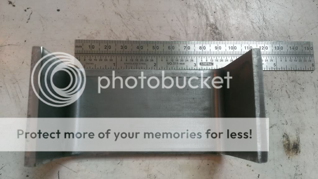

I just need ALL the dimensions for a flip kit (well, ATLEAST one piece!) I found some 7000lb "hangers" or something at my local Tractor Supply... I've also found a COUPLE pictures online, but not detailed enough.
I'm kind of working on a budget until I get a settlement, but the ass end of this truck MUST be dropped! I have more time than money AND I'm a part time machinist, so metal stock isn't a problem. I'd rather save my 60-70 bucks on something else, such as a new 4.10 rearend from the local Pick n Pull!

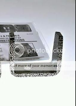

Here's the measurements I found online... Not MUCH, but atleast something!

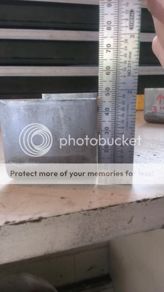

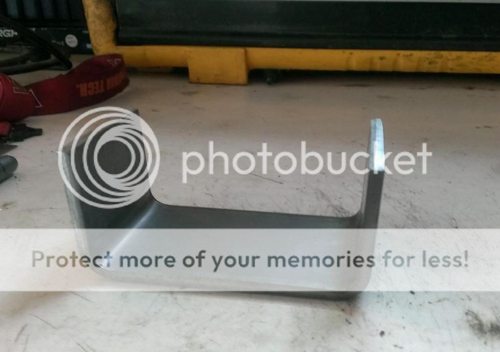

With that shown... Here's what I grabbed from the store (for a 7k lb trailer), if the "sides" were higher, I'd be in business...

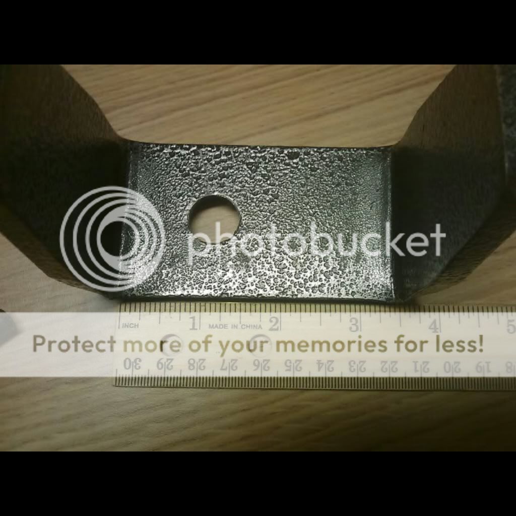

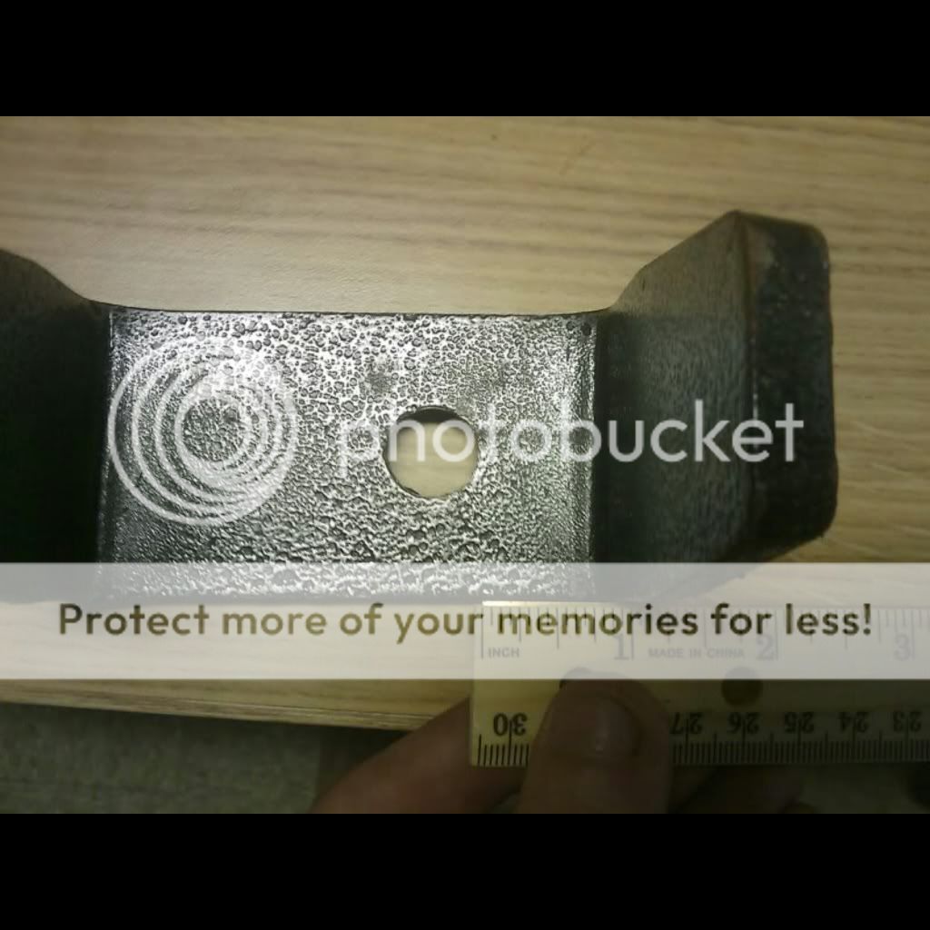

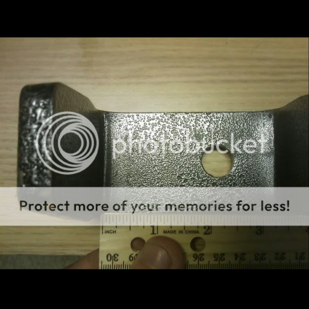

Now here's the measurements that I TOOK on these pieces....
Sorry for the somewhat blurry pics, guess i should've used the Macro Setting on my phone! Lol...
NOW, if someone could just show me "precise" measurements, I could probably make these. I'm wondering if I can just take a couple pieces of flat and weld them up on the sides to make them go UP into where they're supposed to. Or does anyone think that would be a bad idea? :icon_confused:?
It would be MORE than appreciated if someone could show or type out the lengths of everything. I think the only part that's REALLY not going to work are those short sides... Anyone have any ideas? And obviously I would have to put it on the drill press to get those holes in there, so it "pulls back" away from the tranny!

I have that same bracket sitting right here, from DMJ. Side legs are 3 1/2" tall and 2 1/8" wide and .38" thick with the coating. That hole is .700 dia. Have a drawing of it somewhere. For those wondering what it is, it's the bracket that fits inside the existing axel perch to get the drop.

Thanks a ton dude... Did you break out the calipers to get that .38 and .700 measurement? Haha... Just what I would've done!
