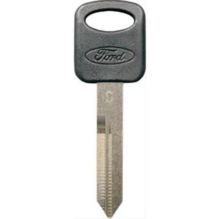

What does the key you have look like?
The current key looks like this.

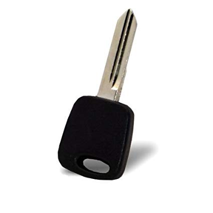

The replacements I got for it look like this. And these definitely have chips
Ball peen, chisel, channel locks, and a good pair of needle nose vice grips or slotted pliers, and you got yoself a bran-new-to-u eff-seereeeeeesss
Truck started right up so definitely no PATS...
I guess ford figured no one wants to steal F350s :dunno:
