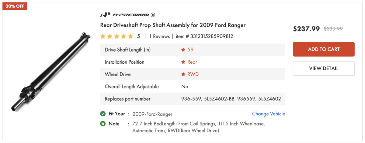

This is the best price I've found on a replacement drive shaft.
Has anyone installed aftermarket parts from "A-Premium"?
How did they perform?

I haven't but i, myself, would get a driveshaft from a junkyard and throw it on.
