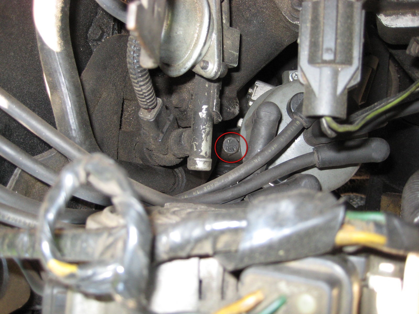

Hey guys,
Maybe I am just blind- but I can't find the distributor hold down bolt on my '86 Ranger, 2.3L.
Any hints? Pictures appreciated!

The bolt hole is in the block on the back side of the distributor base directly towards the block. I use a 11/16 wiggle socket on an extension.:)shady
Here is a photo, the bolt takes a 17mm socket:
Thanks- I barely saw that bolt last night and was hoping it wasn't it!

The hold down bolt is a 17mm, but not everyone has a 17mm wiggle socket, so you can use a 11/16. The bolt is a bitch to access. You can get to it with a combination wrench, but you have to go under and up, and then it only turns a little bit at a time. A wiggle socket on an extension works better.:)shady
