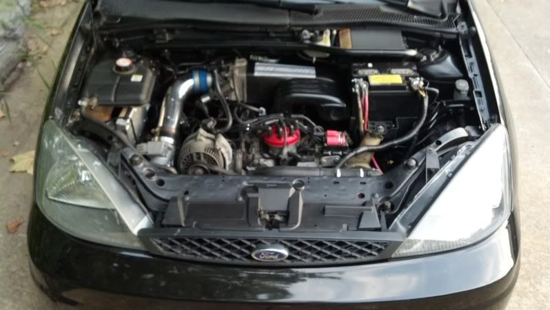

Current state

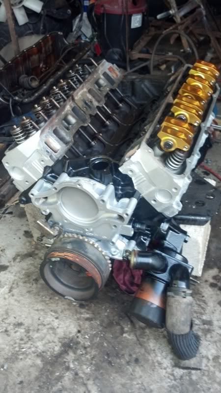

Explorer block

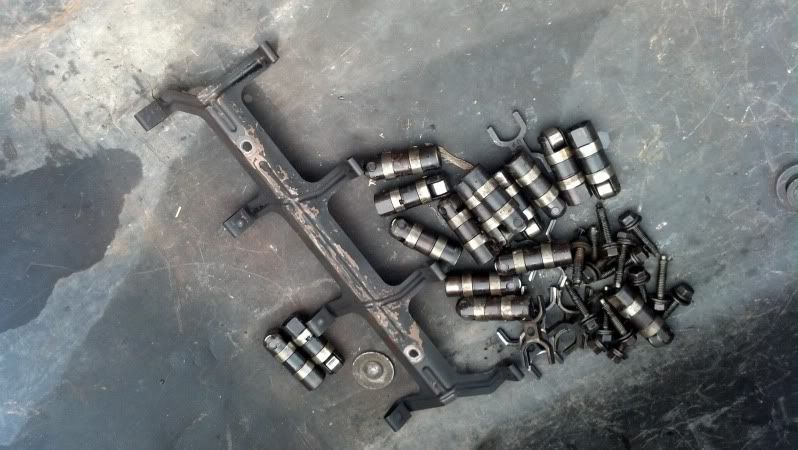

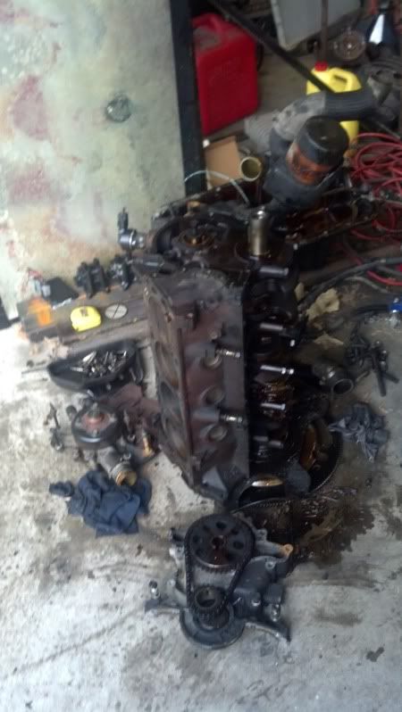

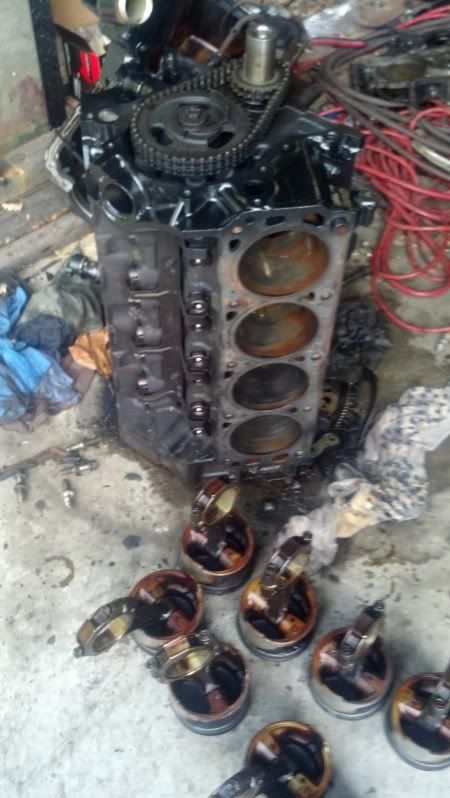

Partial teardown

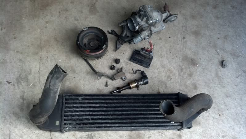

Distributorless electronics (maybe an intercooler)

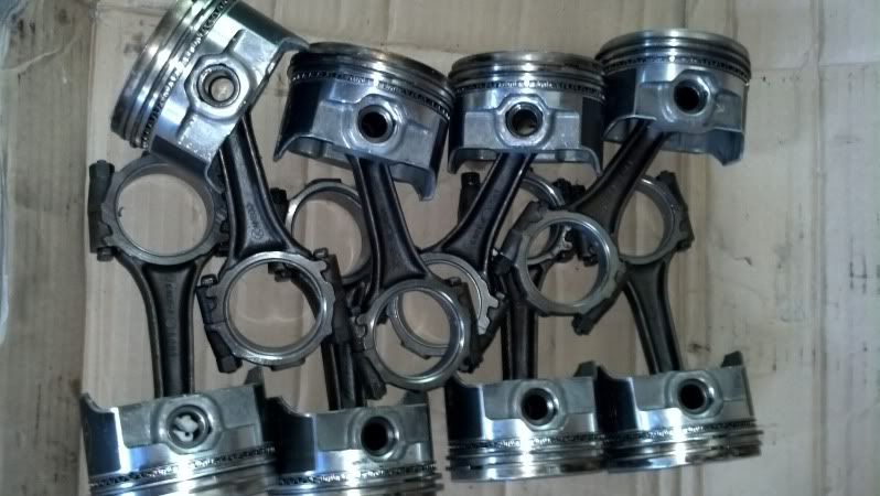

Foxbody rods and Speed Pro pistons

F150 lower intake (larger runners and AIT in manifold)

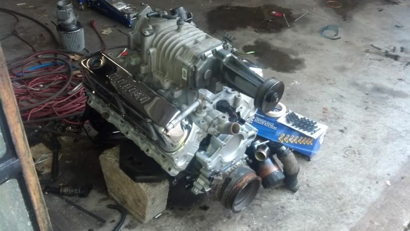

M90
