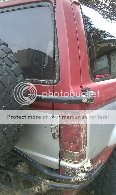

Also re mounted my CB antenna since it just about got ripped off.
You might suffer some range lost, and high swr's, if your lid is like mine and fiberglass, your not going to have a good ground plane.
you might have to run a ground wire to the base of the mount to help
Robert
i would have mounted it to the swing out tire mount.
You might suffer some range lost, and high swr's, if your lid is like mine and fiberglass, your not going to have a good ground plane.you might have to run a ground wire to the base of the mount to help
Robert
It doesn't matter what surface or where it is mounted, it is always a very good idea to run a ground wire to the mount :icon_thumby:
SVT
It was. The part where the pipe gets thinner. The rest was too thick. I tried to weld a piece on it too and it wouldn't stick. Must be aluminum or something. Any way here is where it used to be. It just about got ripped off on a tree.
