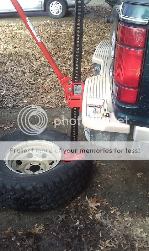

Took advantage of the nice weather. Have had a slow air leak in both front tires since my last trip out. Broke both down today and dug all the boulders and branches out of the bead. Props to Jay and Rick for showing me this trick.
