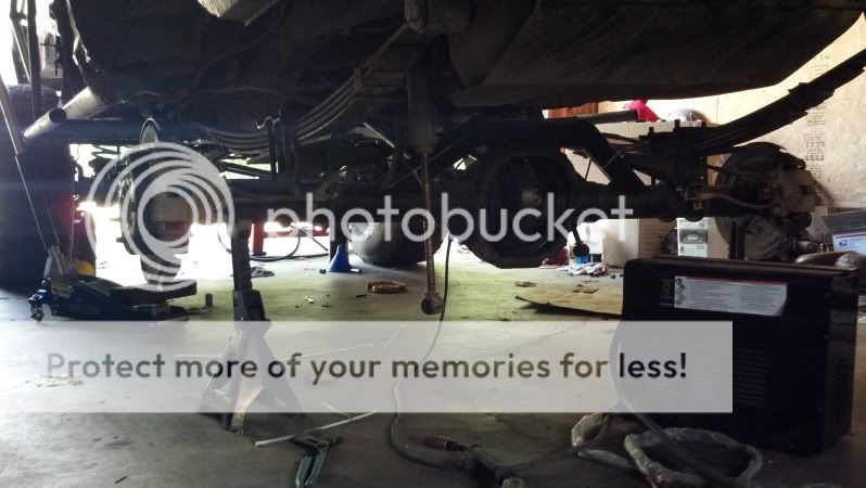

Ok little update on the B2. It moves. It still leaks, but it moves. Got it in the garage so I can finish up the rear axle and install the rear driveshaft.

Got the rear finished up and drove her around the neighborhood. Still leaking like no other. Not really sure what to do about it.
