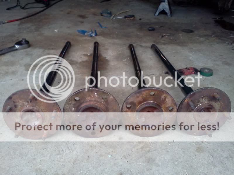

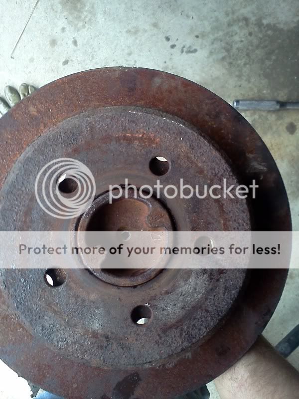

So I found out some 8.8 shafts have the large hub, but some are the same as the explorer. So I picked up a set. Now the only thing keeping the disc brake swap from being bolt on is drilling new holes in the rotor.
Large and small
