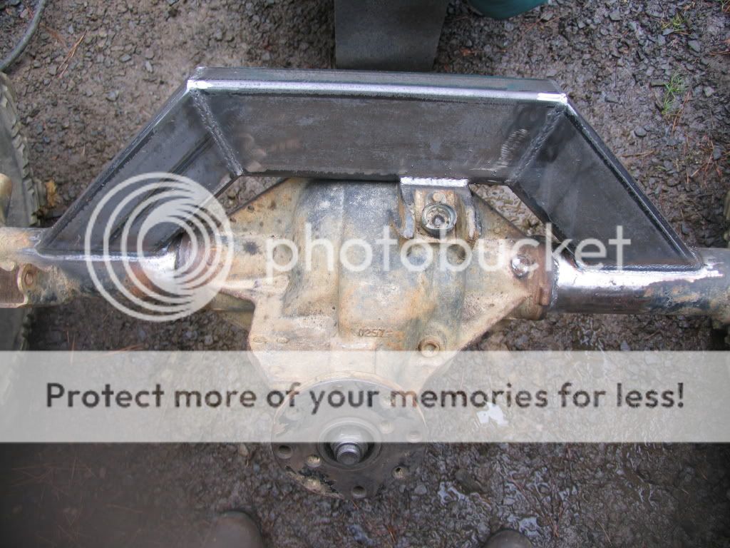

Ok so I am going to build a truss for the 8.8 while its apart. I have some 3/16 1.5" square, and some 1/4 2" square tube to work with. I think I am going to use the 2" on the 8.8 and save the 1.5 for the 44.
Looks good. You may have some issues installing it, they can be tricky with gearsets lower than 410s...

This is basically what I am thinking for the truss. Simple, effective.
