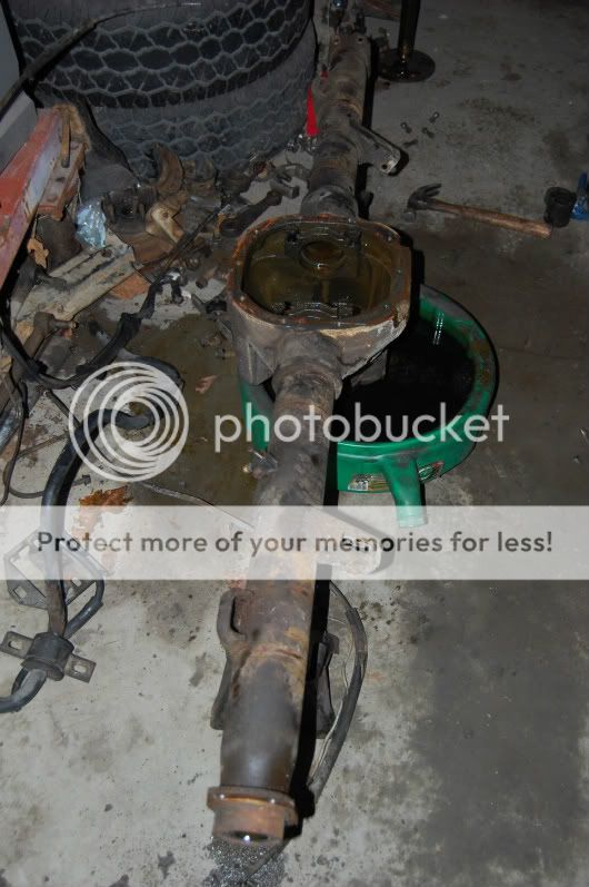

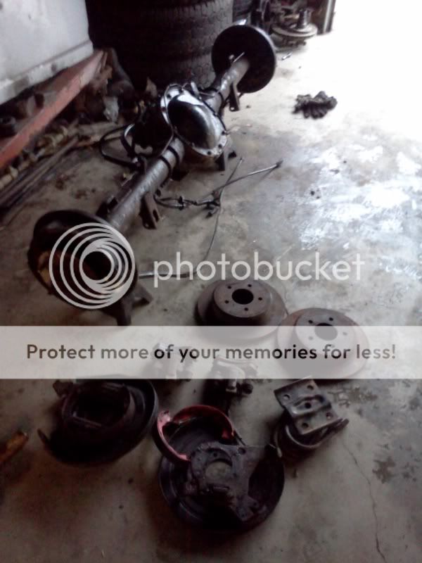

My new FW 8.8 and hopefully everything I need to swap it to disc brakes.

You just going to use the gears in the current axle for the fw8.8?

what are you using to run discs?
Redrilled Explorer setup.
I did some research. Thought about running 97+ 8.8. They have discs, but they have a metric bolt pattern and require a minimum 16" rim. So I looked into the Explorer setup. The center hole on the rotor needs enlarged, or the hub on the shaft turned down. Then redrill the rotors and thats it, its bolt on from there and I can keep my 15" rims.
