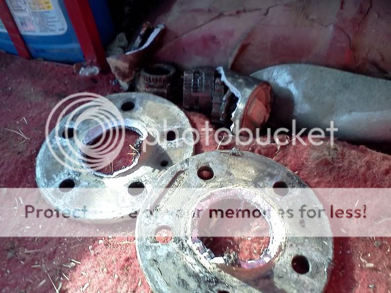

Luckily I had a spare hub, and railman still had a broken one in his truck. Got me out of the trail and back home.
Good news, the doubler works. Unfortunately I can't blame the doubler for the hubs. After cracking the spindle nut, I swapped them out for auto nuts. I was almost positive my spare nuts were missing the pin. And I didn't know the autos wouldn't work.

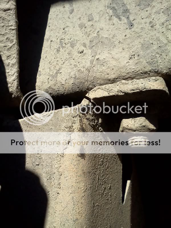

Lift bracket for the driver side beam.
Maybe its time to swap to a solid axle

looks like you ought to brace those brackets when you get new ones or fix the old one
Would going to D44 outters give you stronger hubs? If so I would do that or go to D44 TTB.

i vote 44 outters!!! thats pretty trick
then you have to do somthing for the rear tho if you want matching lug patterns.
