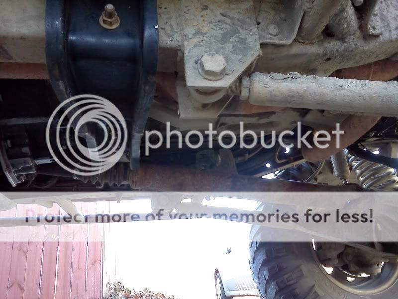

will a speedo cable from a full size work in a ranger, i have the same problem put a doubler in my ranger and now the speedo cable is to short.
now I really want a doubler... next winter's project. that and tires
Yup. Got mine out of an 80's F250 4x4. I was told the F150 works as well. Don't know about any others.

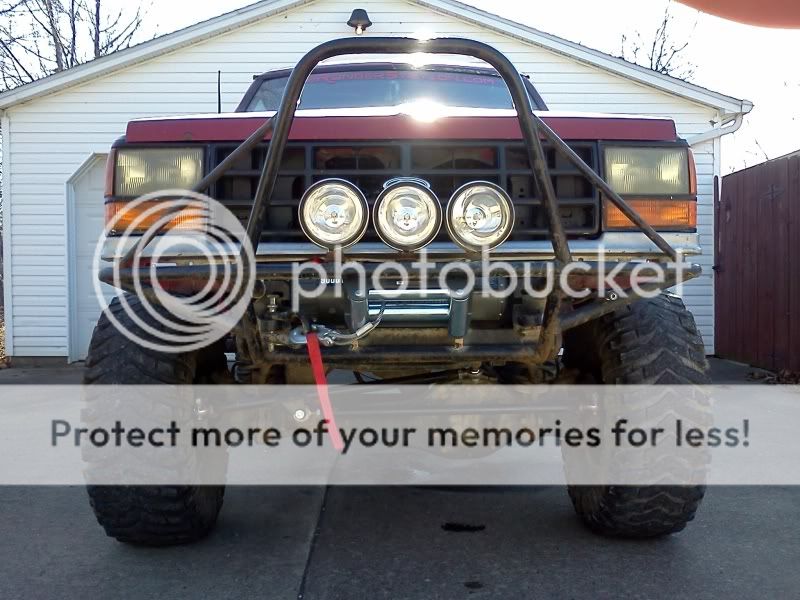

Well I got the winch wrapped up. Took a little longer. I had to fab up a bracket for the fairlead. I thought it mounted to the winch.

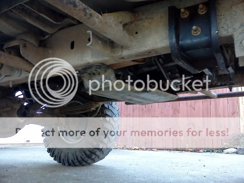

And I almost forgot my skid plate. Seen it as I was putting stuff up for the night. Gotta get that thing relocated. Don't need to be bashing tcases against anything.

The mount for the fairlead is temporary.

Looking good. Looks like its time to beef up those RA's now...
