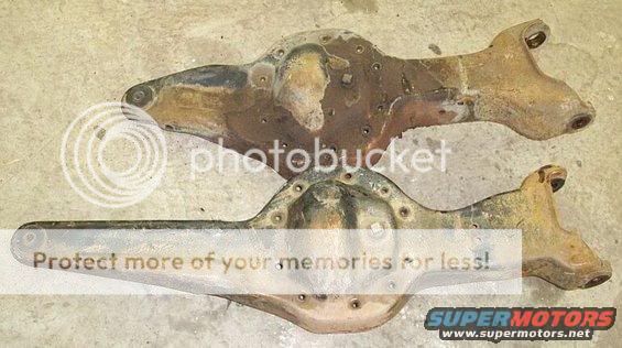

I will have to check my brothers truck. His f250 should have the d50.
Interesting stuff. I knew the spindle nuts were interchangeable, but didn't know the bearings were the same diameter.
They must have changed the spindle over the years though. It seems the 6 bolt one is more common.

Ok so apparently the older F250s had a D44HD and the newer ones were D50, but they all had the short beams.

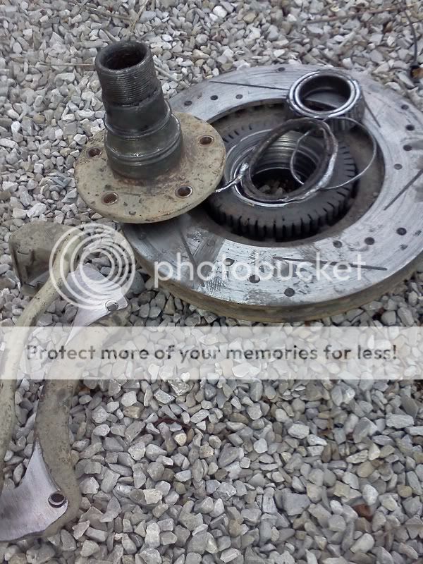

Went to leave for the u-pull this morning and the radiator decided to crack. So I pulled it back in the driveway and swapped it out real quick.
Then I was having something weird going on with my brakes so I pulled the wheel and took a gander. Rear bearing had apparently been bad for awhile. Maybe that was my problem and not my ball joints. Aint been a good few days for the B2.

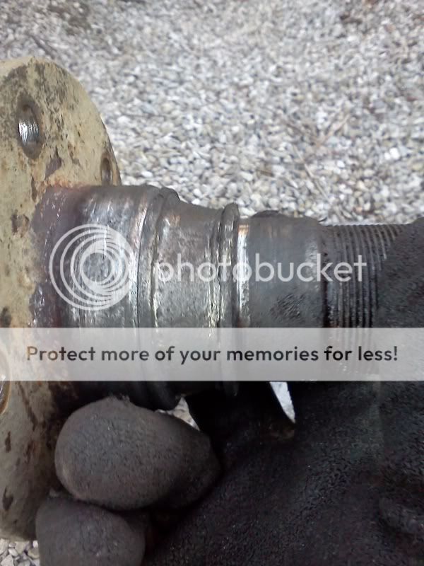

This bearing is now a permanent resident

I swear I could repack the wheelbearings with my eyes closed when I had the d35. I checked them OFTEN.

I had one of those. Pulled maintenance, went to TB, had a bad run/day, limped it home, let it sit, went to fix all that went wrong and had to beat the hell out of it to get it apart.
