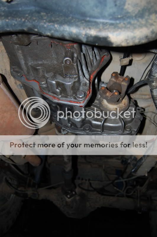

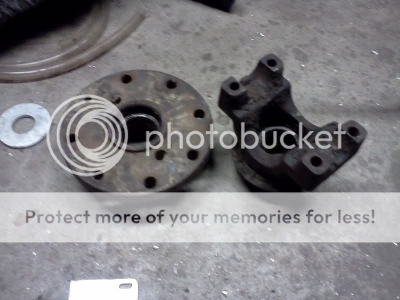

Ok rear driveshaft is done. Ended up swapping the rear flange out for a yoke off an F150. Now I have a yoke on both axles and both ends of the tcase.

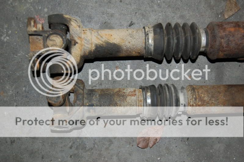

And I think I found part of my measurement error. I must have measured with the slip yoke from a front shaft and then installed it with the slip yoke off a rear. I was still off a little, but now I know my error and can use the other shortened one as a spare. Here you can see the difference.

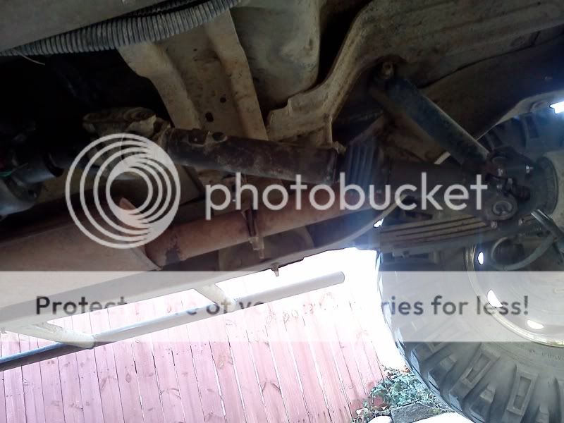

Here's a better pic of the rear shaft.
disciplerocks's B2 build thread
It looks like the drive shaft will bind when the rear end stuff's?
might have some slip to it. the boot looks like it is still around the splined area. but not somthin to mess around with. damaged case wouldnt be fun just after putting them in
I'll have to pull it and install without the boot. And the rear will be raised about 3/4" here pretty soon.

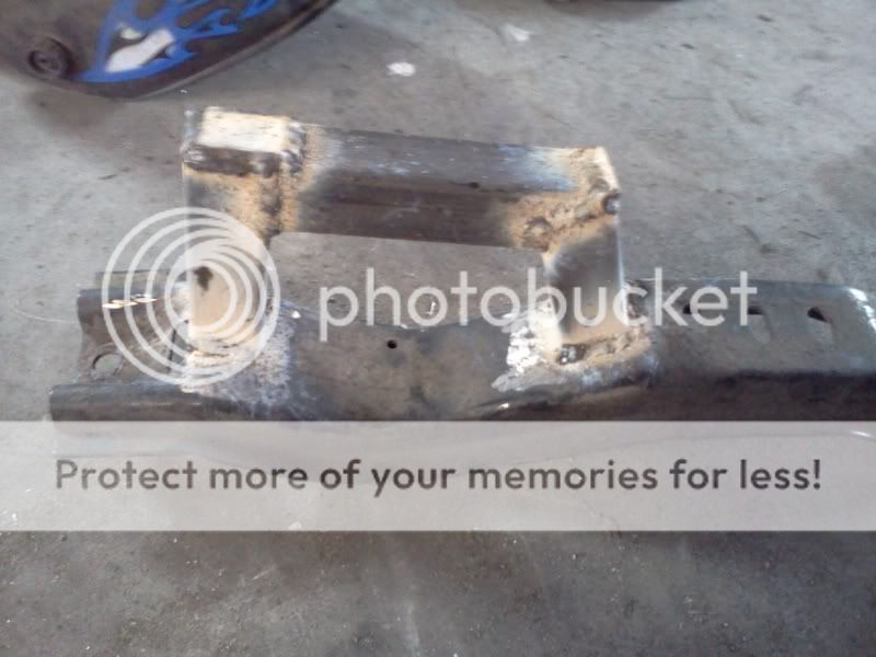

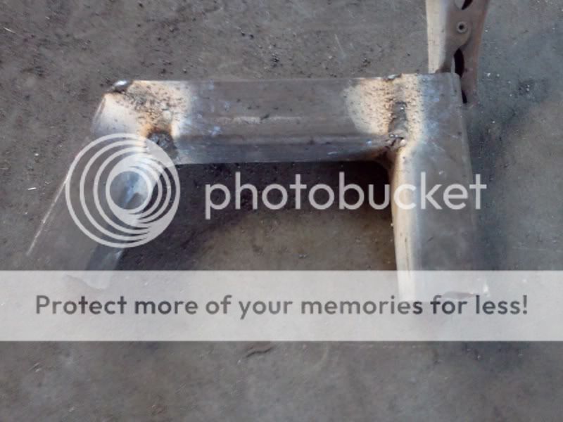

Crossmember. I was going to build a complete new one out of 1.5" square tube, but got lazy. Kinda want to get this done so this is what I did.

Your crossmember looks familiar:

I was actually reading your build thread last night after deciding to mod the stock xmember instead of building my own.

I planned for that to be temporary and build a new one. Almost 4 years later - still rockin it. haha

New crossmember installed. And I find that the Explorer sport rear shaft wont work. Need one thats 36.5" static length (center of u-joint to center of u-joint).
