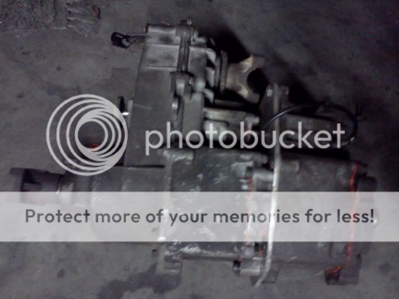

Doubler is complete. Everything is sealed, locktighted, and the d-case is filled with fluid.
disciplerocks's B2 build thread
1354E - t-case
1350M housing with 1354 internals and planetary - d-case
1354 front yokes on both ends

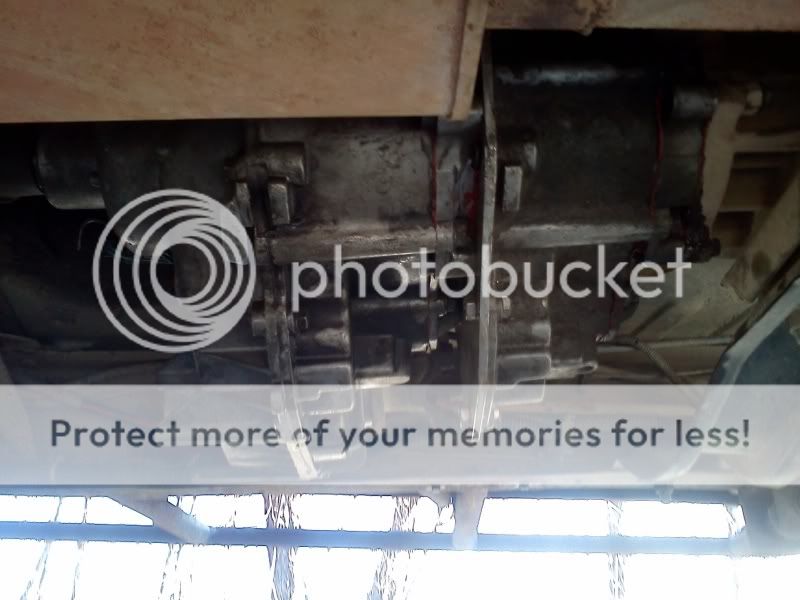

Driveshafts and t-case removed in a half hour. Doubler installed in 3 hours.
Unfortunately I measured something wrong and the rear driveshaft is about an inch too long. I jacked up the rear to fit it on, but I am going to have another shortened when I have my front shaft made.
