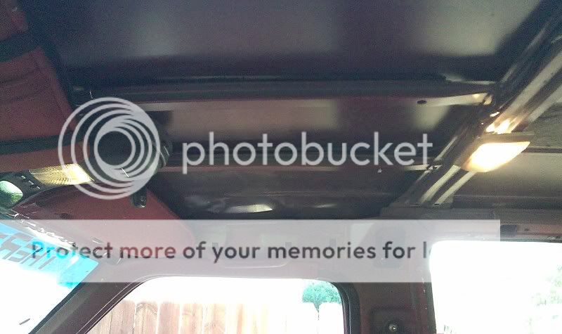

Also just took the B2 for a cruise to test the OHC. My phone said it was 87 degrees. And the console read between 85 and 89 during the whole drive. The compass was off though. Had to do the drive in a circle thing, but after that it was spot on too.
I wired it to the dome light, but also to the battery so both lamps can work independently without the key.
