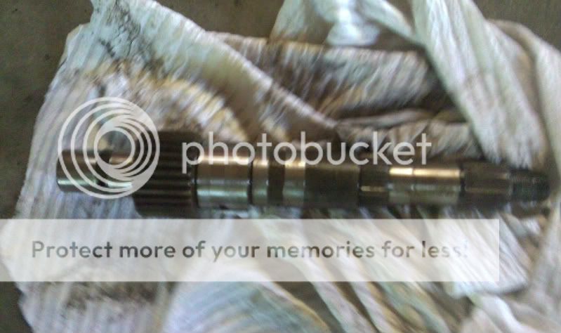

Ah the infamous shaft. The single most difficult part. May try to get a quote this week just to see what I am in for.
If you cant find one, maybe it would be cheaper to go get it from him in gas cost then what a JY wants for a tranny (plus get to see eachothers vehicles in person too).
They are about $80 here. It would cost at least that just to drive up there.

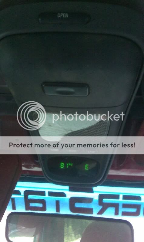

Im jealous. I have the one in my truck that came with the map light and the clock with estimate timer and month/year.
I have one of those laying around here too. I'm still looking for a tripminder.
