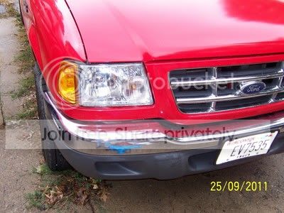

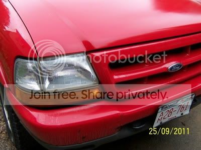

The grill from 2000 are even different than the '03's, slight but different.

Ya I see it. Instead of the light on the bottom its just plastic.

like Dave is showing, the 01-03 has a plastic "wing" under the headlights.
that would require to get the 01+ heads or do a custom cut on the grille.
As u can see the 04+ grille comes separate, as the 98-00 does.
images
the plastic part under the lights comes on the plastic panel that goes behind the grille, so u can keep your 98-00 lights and turns
